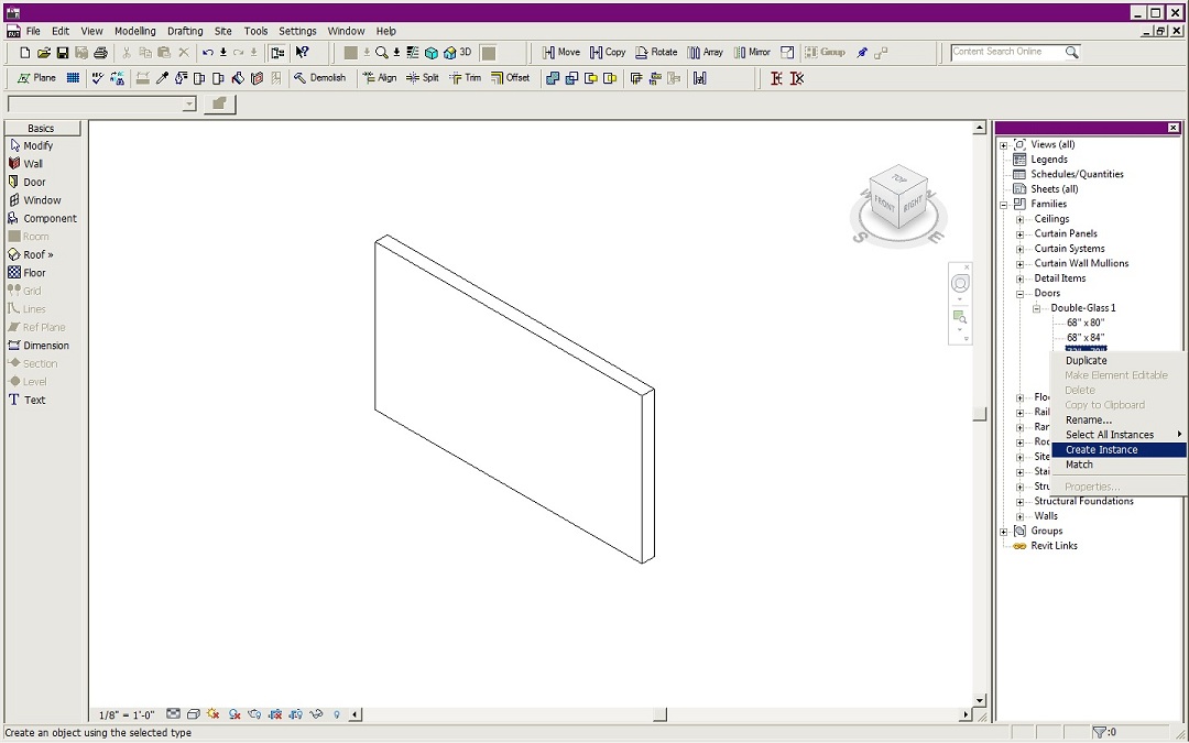

You were probably just in the wrong view to use the component that you just loaded. But this doesn't mean the family is not in your project.  In the plan view, click on the door tab and select it from your choices.
Also, if you have successfully loaded the family, find it in your browser, right click on the correct type and pick create instance.
