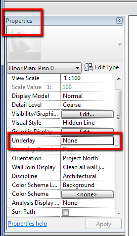

Hi all I'm fairly new to revit and I'm having a problem that I can't figure out.  I'm working on a residential house and for some strange reason all of my first floor casework (countertops and vanities) are showing up in my basement plan.  So I was wondering if someone can help me figure out how to get my first floor casework, not show up in my basement plan?
Mon, May 9, 2011 at 12:38:06 PM | component visibility
Joined: Tue, May 22, 2007
5921 Posts
4 Stars: 205 Votes
In that level check your "Underlay"
Mon, May 9, 2011 at 12:46:14 PM | component visibility
jwalexa
Joined: Fri, May 6, 2011
6 Posts
My underlay for the basement plan is currenty set to none.
Mon, May 9, 2011 at 12:54:55 PM | component visibility
5921 Posts
4 Stars: 205 Votes

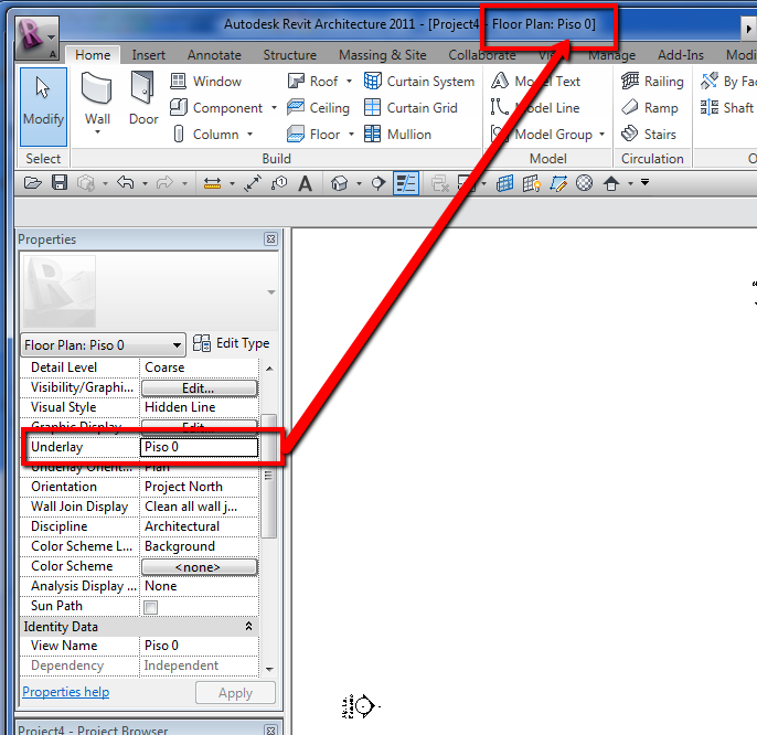

Then try to change to "basement Plan"
Mon, May 9, 2011 at 1:24:24 PM | component visibility
jwalexa
6 Posts
Can't underlay the same plan.
Mon, May 9, 2011 at 1:42:08 PM | component visibility
5921 Posts
4 Stars: 205 Votes
Yes you can.
Mon, May 9, 2011 at 1:42:23 PM | component visibility
jwalexa
6 Posts
Mon, May 9, 2011 at 1:56:25 PM | component visibility
jwalexa
6 Posts
typhoon...sorry about the double post.  I'm working with revit building v8.1, pretty old.  So there is no option for me to underlay the same plan on top of each other.  I think it may have to do with a V/G problem within the family.
