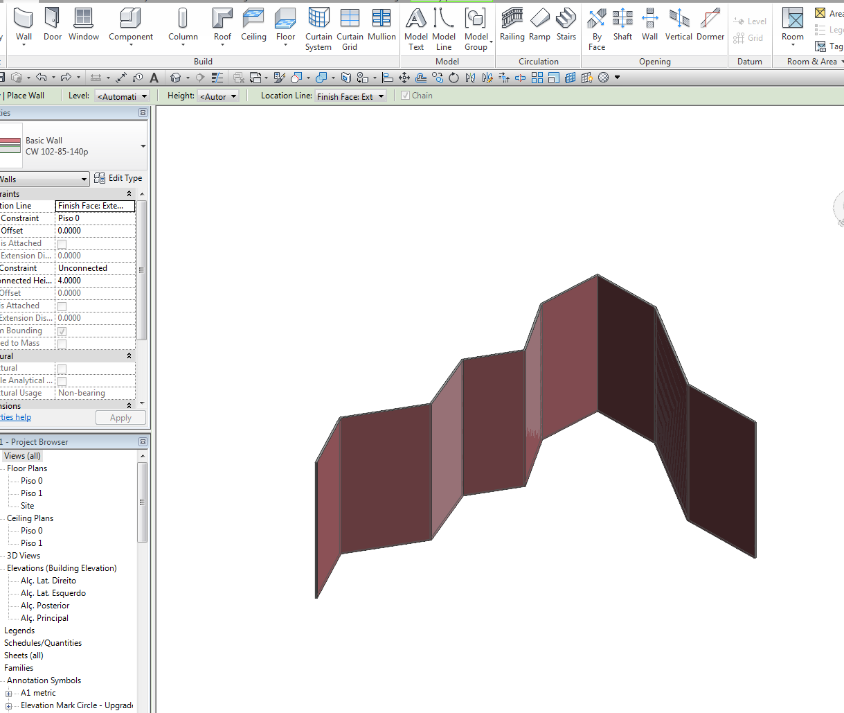

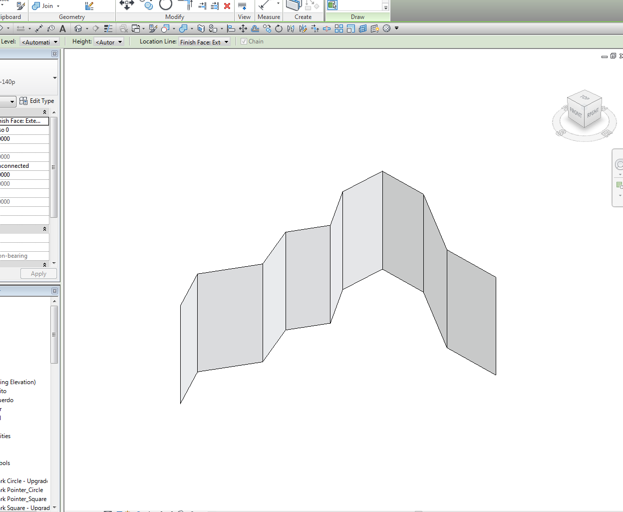

Hi,
I have a lot of faces I like to select and change to walls. Is there and easy way? It seems like it's not possible to select multiple faces when entering "create walls by faces"
Thx
Fri, May 6, 2011 at 1:26:45 PM | Picking multiple faces when creating walls
Joined: Tue, May 22, 2007
5921 Posts
4 Stars: 205 Votes
Use the "TAB" key to select a chain of faces...
Fri, May 6, 2011 at 2:12:40 PM | Picking multiple faces when creating walls
B0bTheBuilder
Joined: Fri, May 6, 2011
9 Posts
Waw, thx Smile!!
