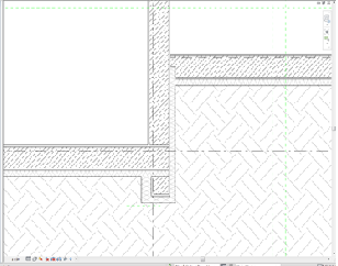

just took a look at my ceiling plans for the first time and noticed that all my labouriously aranged wall joints are all messed up, insulations go past walls, walls are unjoined or are different leghts. my walls consist of a 3-5 layers aranged so they join in plan and section without too many problems.
so is there a way to do wall joints properly or ceiling plans properly?

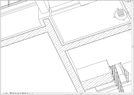

just took a look at the ceiling plan from the 3d crop view and this problem doesent exist there. so its nothing to do with the model...

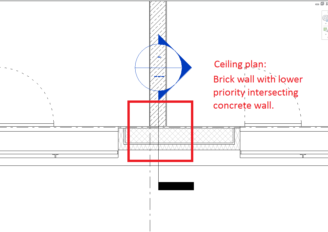

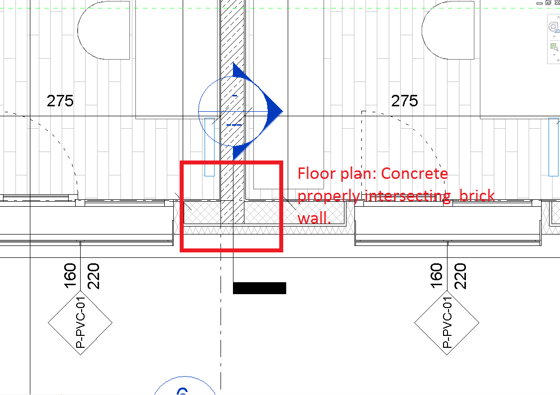

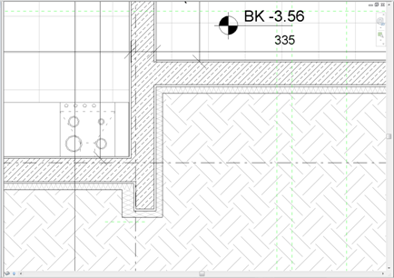

the first image is the ceiling plan, the second image is the floor plan and the third image is the 3d view.

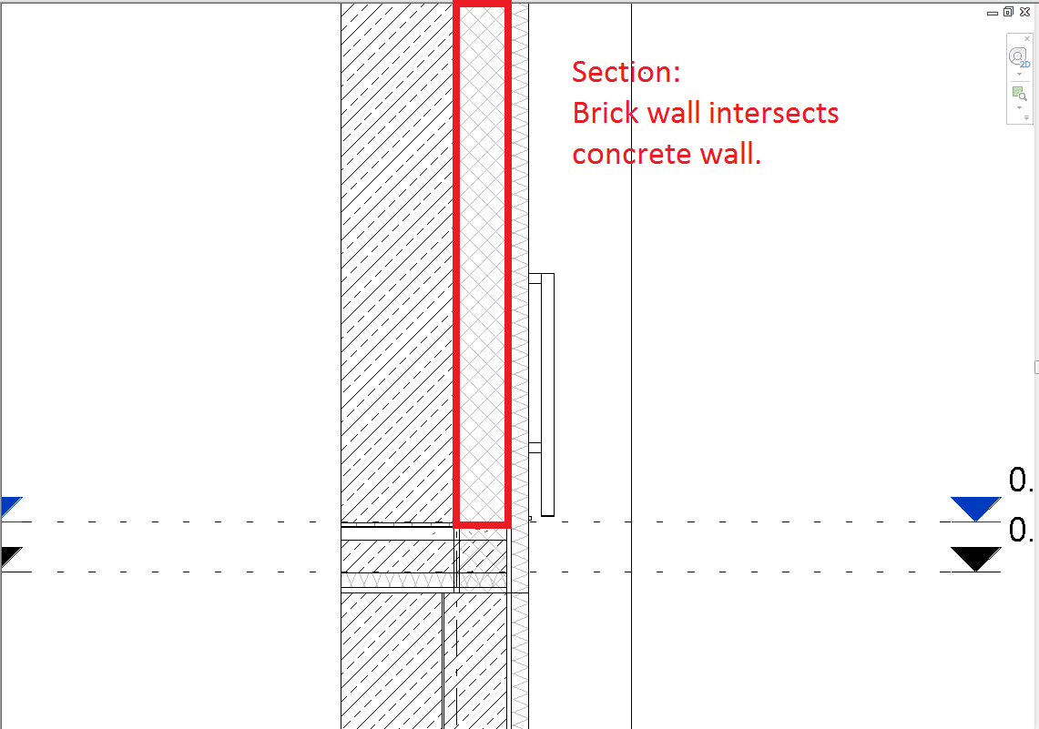

OK. i used dissalow join to make my walls join properly. it seems that the ceiling plan doesent see this action at all. and even worse, when i make a section through that part of the wall the section is like the ceiling plan. the dissalow join comand doesent work for ceiling and sections...

Cut sections through the offending walls at the problem area and look there.
Also play with your cut plane in the RCP and see what happens.

did that,  the section shows the same thing as the ceiling plan, insulation and bricks intersecting the foundation walls even though they are set lower in terms of priority in the layers...
it is as if the ceiling plan and the floor plan have different models. i cant get the same join in the floor plan

no the model shows two different things. the plan and section arent the same.  the square hatched wall is set as substrate and the hatched wall is set as structure. every thing looks fine in the floor plan but not at the ceiling plan and section.
the fix to this that i have to re do all the wall joins again. but shouldent the floor plan and ceiling plan be the same?  and why include a command as dissalow join if it doesent actually do that in the ceiling plan. so i still dont know withc one of these is what i actually drew. the 3d view is the same as the floor plan, the section is the same as the ceiling plan
