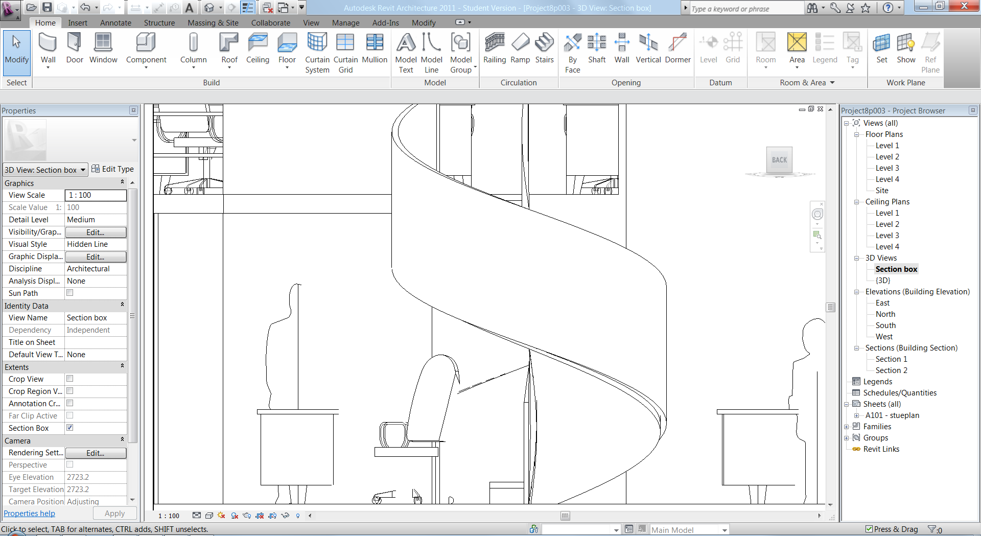

I made a solid railing extending all the way down to the stairs, but it doesn't follow the incline of the stairs comlpetely. Resulting in a not so good looking stair. Any ideas of how to make the railing follow nicely?

If this is a railing, do you have it hosted by the stairs?

Go to the Edit Sketch for the railing and click on "Set railing host" and then select the stairs (the host) if the railing is in fact a railing as WW mentioned.
