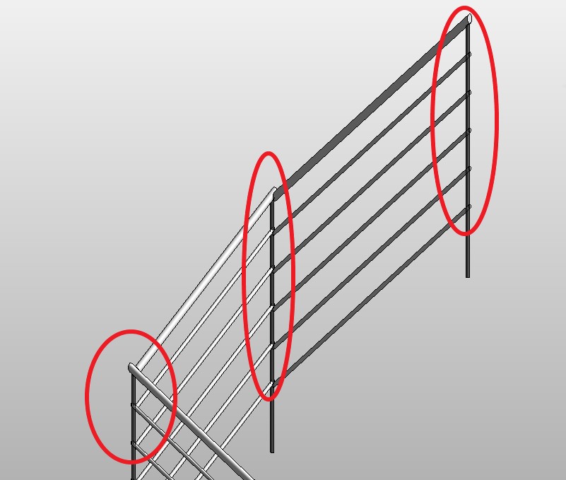

Hi
I have tried different options in "Edit type", "Edit type / Rail structure" and "Edit type / Baluster placement" ....
However the rails couldn't be jointed properly.
Any tips?
Please see the attached picture
Thank you very much
Mon, May 2, 2011 at 8:26:34 AM | How to joint rails properly
Try doing this as one sketch...just use seperate line segments joined end to end.
Wed, May 4, 2011 at 3:44:39 AM | How to joint rails properly
shenlunglinnk
Joined: Tue, Mar 23, 2010
50 Posts
3 Stars: 2 Votes
Thank you WWWHub.
But it doen't work.
Can it be problems of the baluster family and rail family ?
If so, how to redraw them and set them properly?
Thank you very much :-)
Wed, May 4, 2011 at 7:32:23 AM | How to joint rails properly
Do this, sketch a rail using your rail definition using one sketch ... 3 lines conneceted at angles and look at the resulting rail.  It will be continuous with no join problems.
