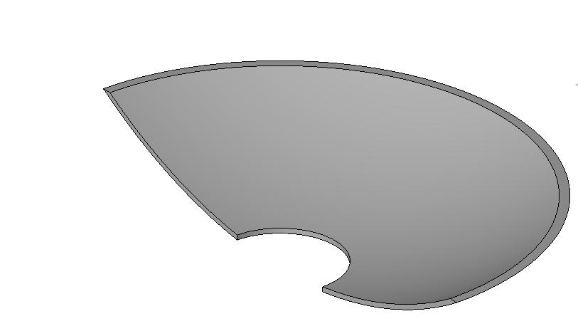

hi,
i need to produce the setting out of the "dome like slab" in the section to show the radius and its exact location vertically. the slab was created using revolve and its edges on the section is not selectable for radius dimensioning, please tell me how do you do the setting out of the dome in section? please help me
thanks in advance please see attached picture for detail

ah nevermind, i already solved this after i abandoned this question before and deal it yesterday.
instead of creating this kind of slab using revolve command, create this using sweep command so that the "trajectory segmentation" tick box will appear on the slab property and from that you can use dimension command to put radius and everything on its section
