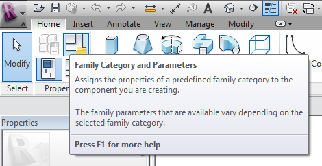

I agree with 'itsmyalterego' but you could start a new family using the "Generic Model wall based" template file. Then under its 'Family Category' change it to Doors.

I didn't want to use the door family template file because—and this is the short version—I was having trouble getting it to do what I wanted it to do (dealing with reference planes). However, I definately can make a generic model and associate with with the door family category as shown! That's awesome. Thanks, everyone, for all the input.
