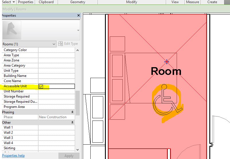

Sun, Oct 25, 2015 at 5:47:08 AM | Room Tag w/ Additional Graphic
Mehr81
Joined: Sun, Mar 1, 2015
0 Posts
Hi kucoyote
I am wonderring whether you could solve this issue.
I have got the similar problem and i would like to control visibility of a symbole with room parameters.
Have attached a screenshot.
Thanks
