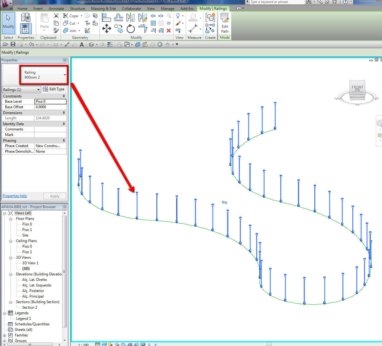

Tue, Feb 21, 2012 at 6:27:02 PM | array on path
70architect
Joined: Mon, Jan 2, 2012
3 Posts
hi,i'm new in revit and i want creat railing like this,bud i cant pick spline pathSadplease tell me more than this image(sry for my english)
thank you
Thu, Feb 23, 2012 at 2:53:16 AM | array on path
70architect
3 Posts
hi again.no help?Sad Sad
i want to creat railing on spline path(like image-post #2)and set my object for array as baluster,the question is how typhoon can do this?(again sry 4 my english)
thank Sad
Sat, Feb 25, 2012 at 5:15:01 AM | array on path
Joined: Tue, May 22, 2007
5921 Posts
4 Stars: 205 Votes
You can't use the pick tool to select the path, don't work, you need to re-create that path with arcs.
