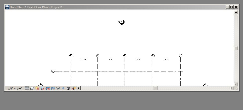

The quickest way to print a "plot area" similar to autocad is to click the restore down button next to the minimise button to cascade the windows. Then adjust the window size to what you want to print. then go to the print dialogue and select 'visible portion of current window' in the print range. This is just as quick as selecting a window area in AutoCAD and there is no need to set up seperate views or sheets. here is a link that documents the process. https://aectechtalk.wordpress.com/2012/09/30/easily-print-selected-area-in-revit/

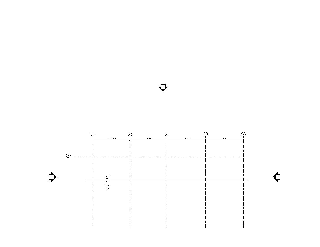

I wish this process works but it does not.
You can see in the first view that the bottom of the model elements is cropped by the window but the print / second view is not cropped.   Also, the view is set to print centered and it does not center vertically.
