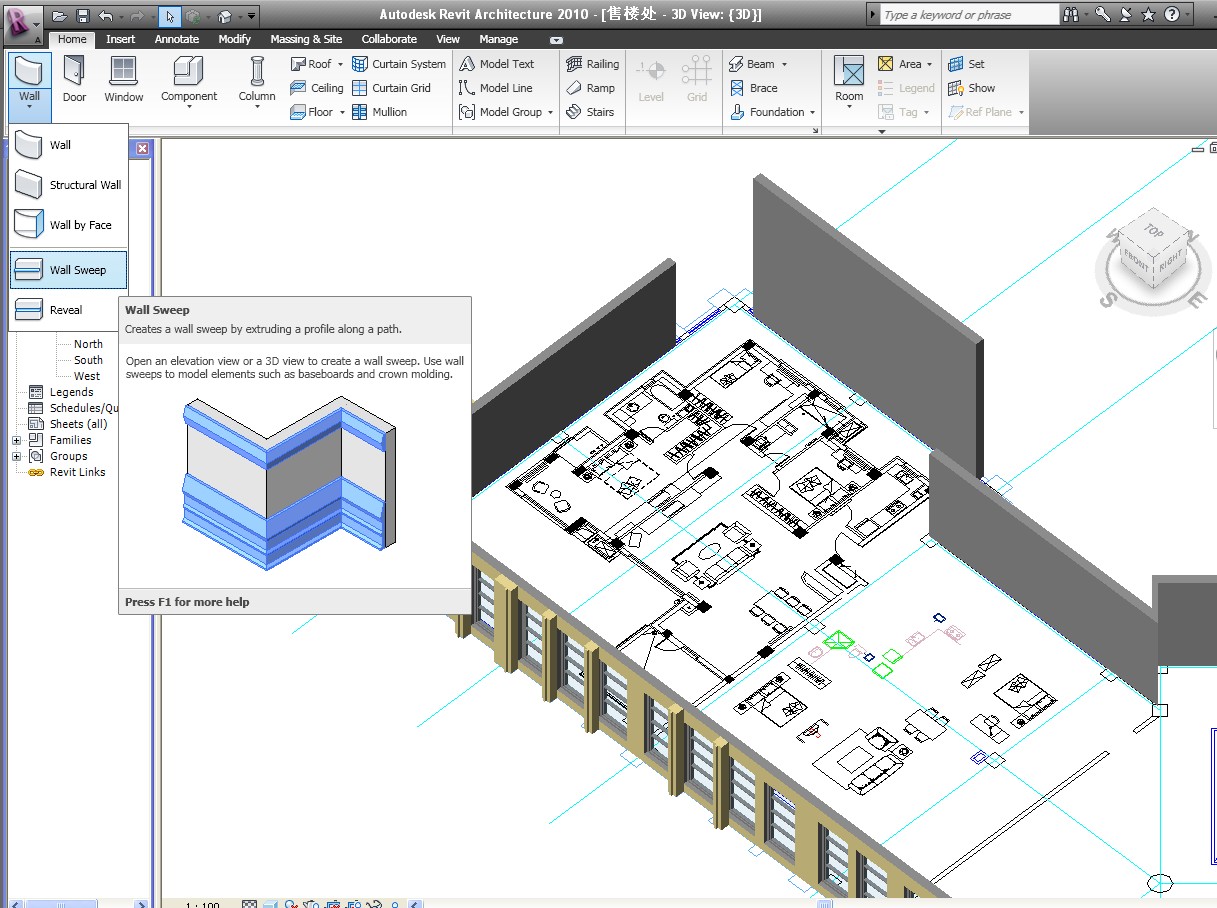

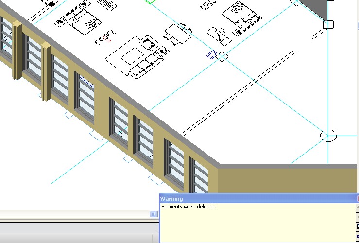

look, my building is like an art deco style, so I need to made many sweeps on the wall, the problems is I can copy  the sweeps, I can just have to put it one by one to use wall sweep, when I copy a sweep, there always ejected an dialog: element were deleted.  Is that wall sweep can  not be copied at all ? thanks.
沧海月明珠有泪
Mon, Apr 18, 2011 at 7:17:46 AM | why I can not copy wall sweeps
First, you can copy wall sweeps and reveals on the same wall face.
If this profile is not cut by a door or a window, you can always consider doing an in-place sweep that has multiple closed profiles.
If you don't mind these sweeps showing up in plan, you can add them to your wall definition.
