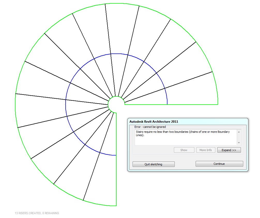

I am trying to create spiral stairs around a single post.  The stairs go 270 degrees and I have all the treads and risers laid out properly.  I planned on creating the stairs with the stair tool and placing a column in the middle, but I keep getting an error message that says "stairs require no less than two boundaries (chains of one or more Boundary Lines)"

Try removing the first and last boundry line and replace them with riser lines.

Ahh okay that worked.
