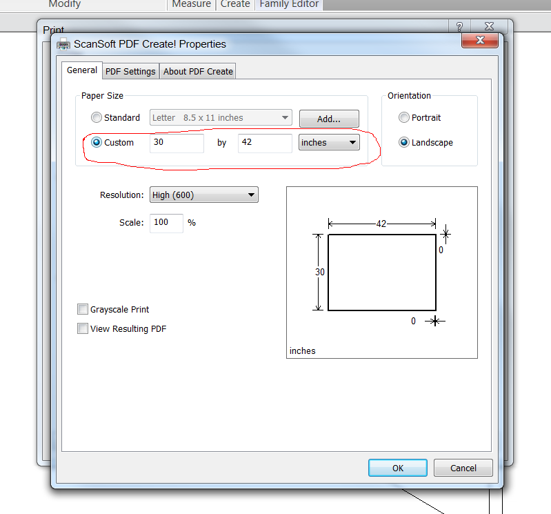

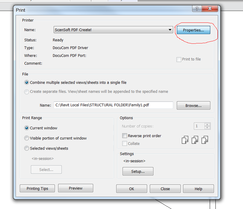

I'm not sure if this is a Revit issue or a PDF issue, but our office has the same problem.  You set up the PDF's to full size, half size, etc.  then go to preview or print and it changes back to 8.5x11.  We figured out that if you set up everything first (paper placement, color, orientation, 100%, 50%, etc.) then your last step would be to change the printer properties paper size to what ever size you need (30x42, 15x21, etc.) and print without changing anything or previewing, it will print correctly.  Not sure if that all made sense or not.  Included couple of pics

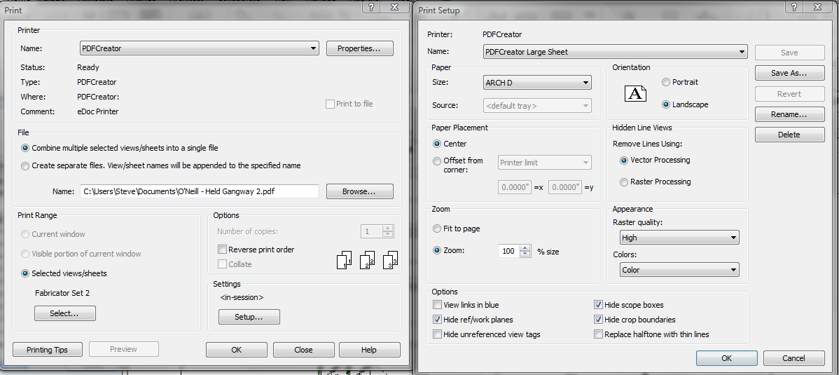

attached please see my PDF set up. I use PDF Creator, which can also generate different type of files as well, free.

I was running into the same problem, I found that if I opened the pdf printer properties in printers and faxes and edited the custom size there (I only needed one custom size) then it used that in Revit. All I had to do was set the print setup to use the postscript custom size.
