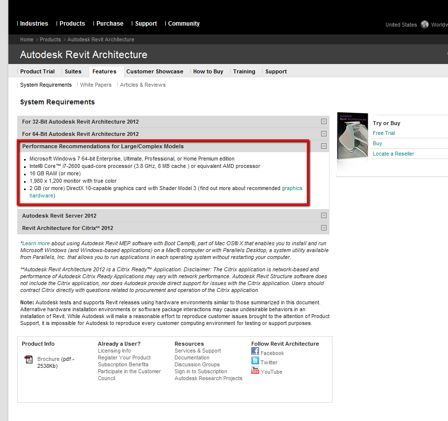

Did you see the "Performance Recommendations for Large/Complex Models"??

Thanks Typhoon,
I did not see that before, but do you know what Autodesk considers a large/complex model?
Thanks, Alan

"...but do you know what Autodesk considers a large/complex model?" - Nope, sorry, I don't work for Autodesk but i will try to find out...
