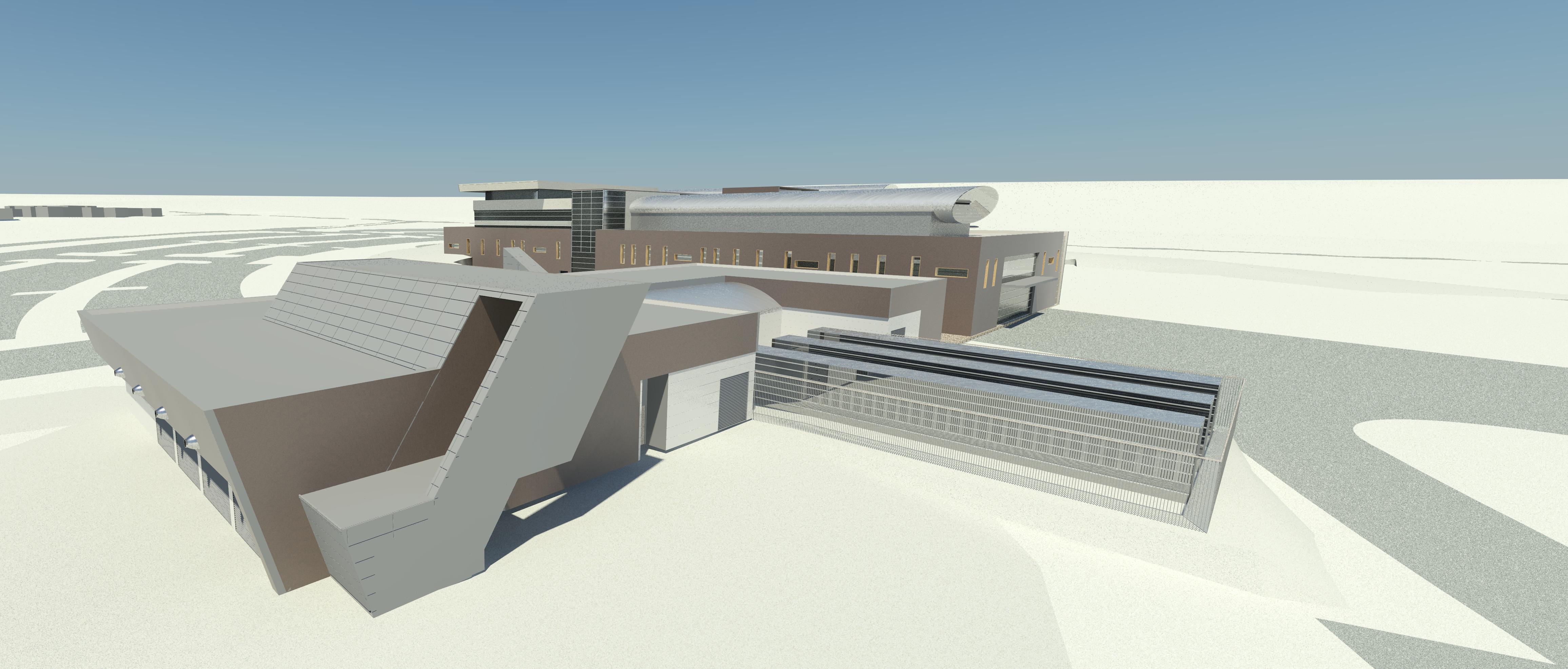

may be you want to have those panels just for the ELEVATIONS and looks:
create a conceptual mass inside your project and line this up with your wall. Than create a Pattern Panel with a void sweep around the panel and apply that to the mass. This way you have the looks and the schedule has the massing too...thats the way we do that here...
advantage: you can create slanted walls and odd shapes with this procedure,,,I attach an image

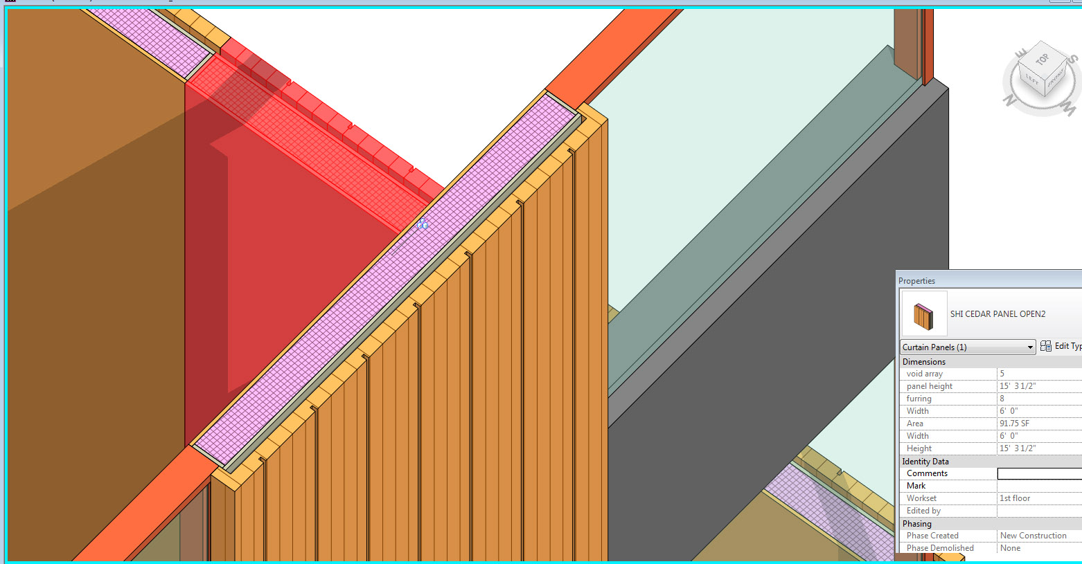

just to be clear -- curtain panels can be quite complex.  They're not just one layer, if you make your own panel families.  They are more frustrating to work with than walls, in many ways, but they're also very highly customizable.
In the project I'm on now, we're using curtain panels because the majority of the exterior will be prefabricated SIPs.
