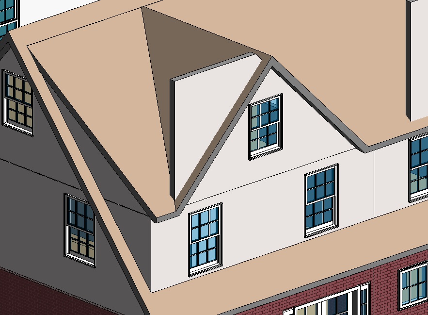

I am adding dormers to a roof and the wall for the dormer does not attach to the dormer roof correctly. One side does and the other does not. I have attached a JPG of the problem. If nayone has any dea as to why this behaviour happens I would appreciate the input. I'm sure it is probably something I am doing incorrectly.
Thanks
Daryl

Maybe try detaching the wall from the roof then try to re-attach it... or just 'Edit profile' of the wall and trace the underside of the roof.
