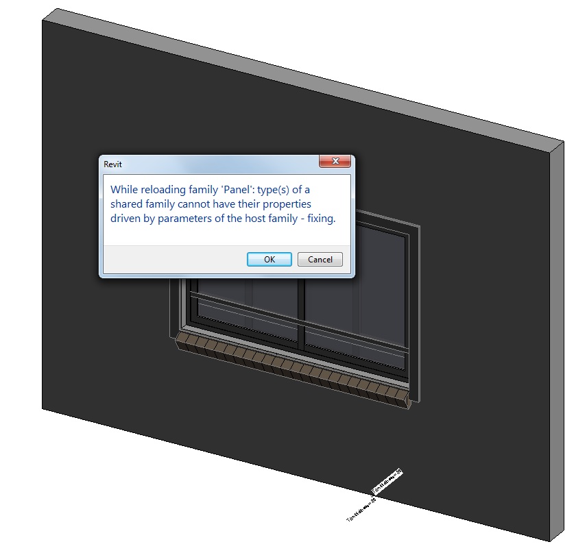

Hi nastyclown, thanks a lot for the tips but when I checked SHARED on the panel family and reloaded it into my window family I got this message saying that I can't link my panel family parameters and dimensions to my window family parameters anymore. How can I fix this?
Thanks.

set the width/height inside panel family to "instance" , that way you can override the width/height within the final family chain... and get control over it.

Awesome. It works!
