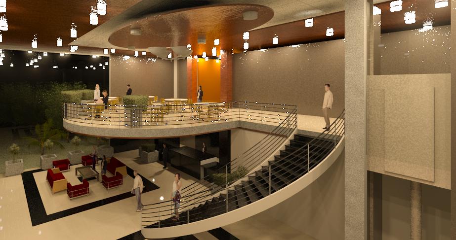

i tried to check it, but it seems that there is no option for self illuminating>> o yeah, the fixture that i downloaded is a visa lighting chandelier.. when i checked on element properties/render settings , everything is on. but still not successfull in lighting up the fixture.. there is an attached picture >> the one thats in the middle is the one thats not lit up
