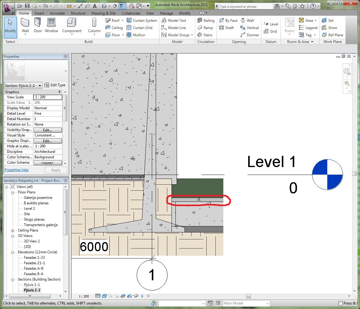

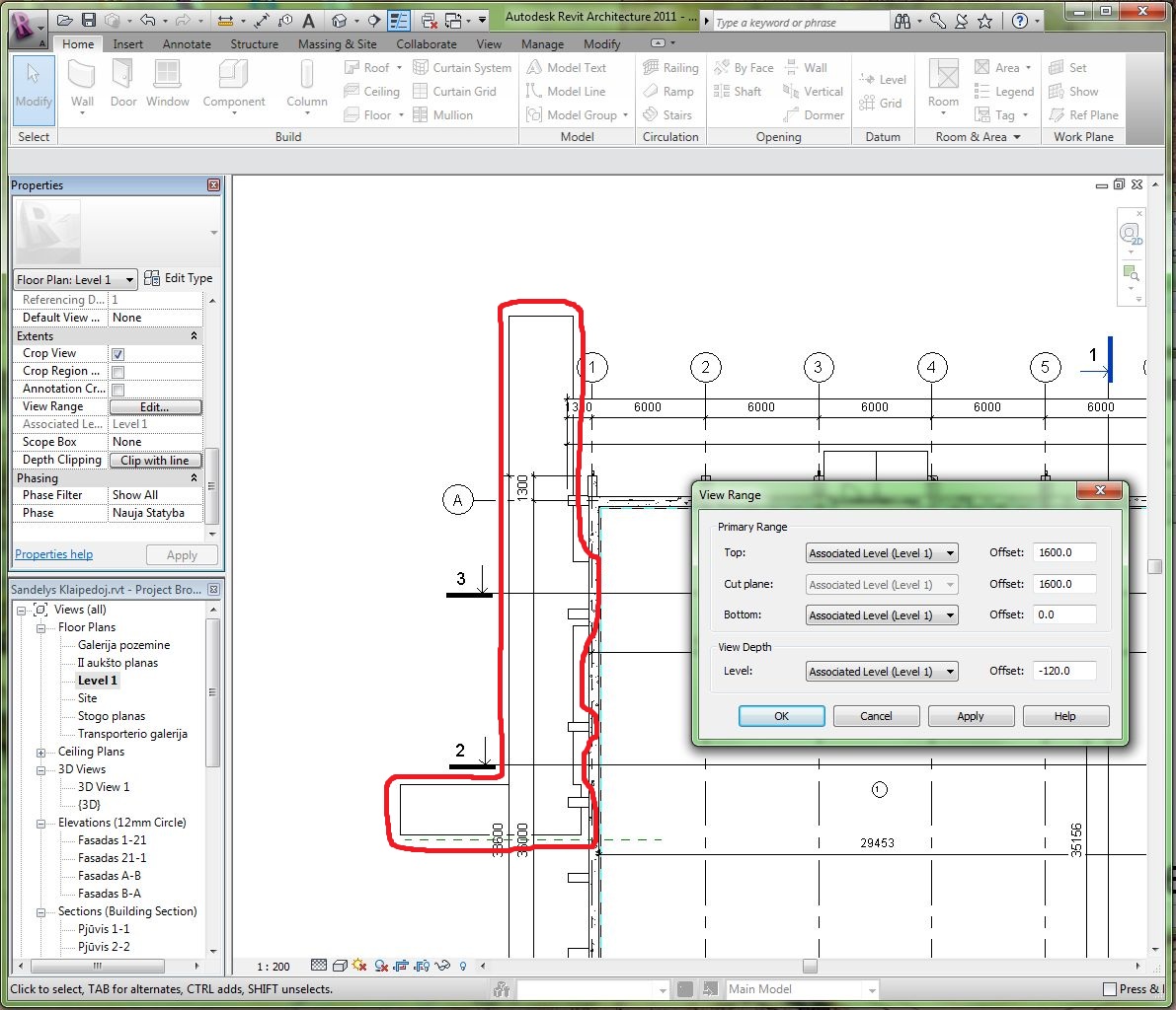

Hello,For some reason I can't get revit to NOT display a floor below the associated level.
The view range bottom cut and view depth are both set above the floor (not intersecting the element)Tried different clipping options and associating the floor with a different level, Nothing that I can think of helps...
Any ideas? pelase help =]

Here's a print screen of the problem. I've outlined the troublesome floor red.

am I correct, you do see this floor in wireframe (as shown in the 2nd image)?
Is there a site above the floor (as shown in the 1st image)?
If so the site might cover up the floor in the shaded view, check your VG.

What I see on your posted clips is view depth -120 for level 1 if you don't want to see that exterior slab set the view plane depth above that. If your interest is showing the footing lines and not the small slab just select it and turn it off for clarity, looks like you may have some conflicts there in any case per your section.
