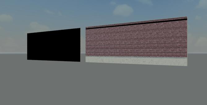

I am trying to texture map a wall.
I used photoshoped to edit and save the image, and I loaded the image up as texture (tried both in JPG, and PNG format) to Revit material. However, when I rendered the wall it came out black.
Naturally, I thought I am making a mistake along the way so I created a new wall and assigned it a wall paper material from the standard Revit library materials. I set the view to render and it came out black again. In order to pinpoint the problem I created a masonry wall this time, again from the standard Revit library, and that came out fine.
Anyone have any idea what is going on?
I have attached the image of both walls side by side for reference.

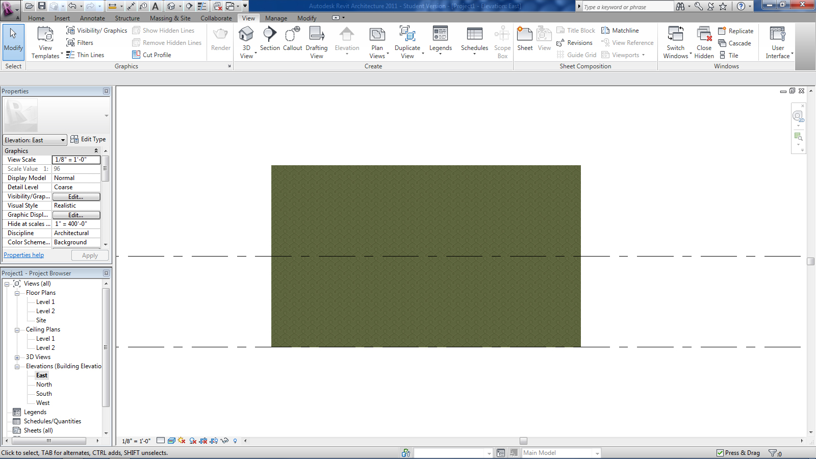

Show us these materials in a normal elevation view - non rendered - realistic view.  Need to see how intense the pattern is.

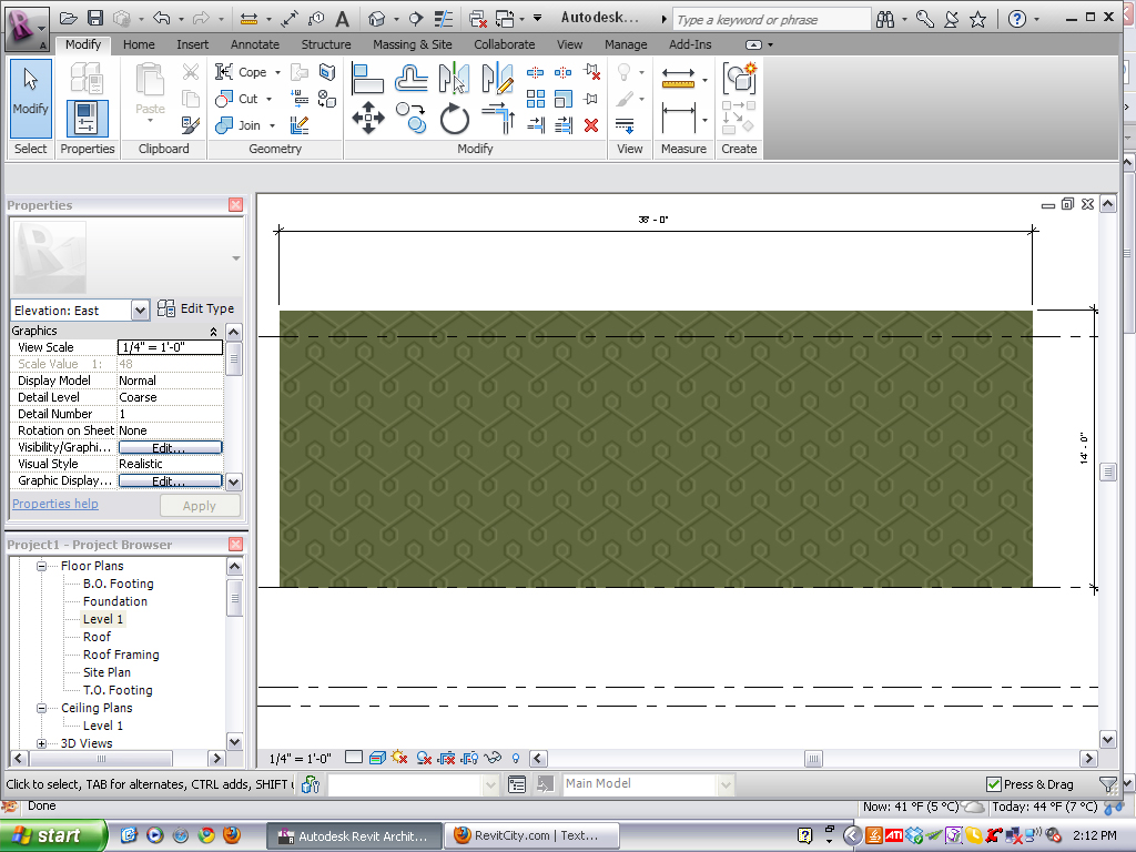

I have attached an elevation view of a wall with wall-paper material assigned to it. As you suggested, I changed the scale of the patch pattern from 8"x8" to 24"x24" and tested it for the render again, but it still rendered black.
See attached image 24"x24" patch scale, elevation-realistic view style.
Thanks a lot for your help
Thu, Mar 31, 2011 at 10:04:52 AM | Texture patterns render black
That material looks too intense for the scale of your view.

I am not sure if I am understanding you correctly. Do you mean that I need to increase the scale of the patch pattern, (so let say from standard 8"x8" to something larger)? If so, I increased the size up to 5'x5' and I got the same result.
