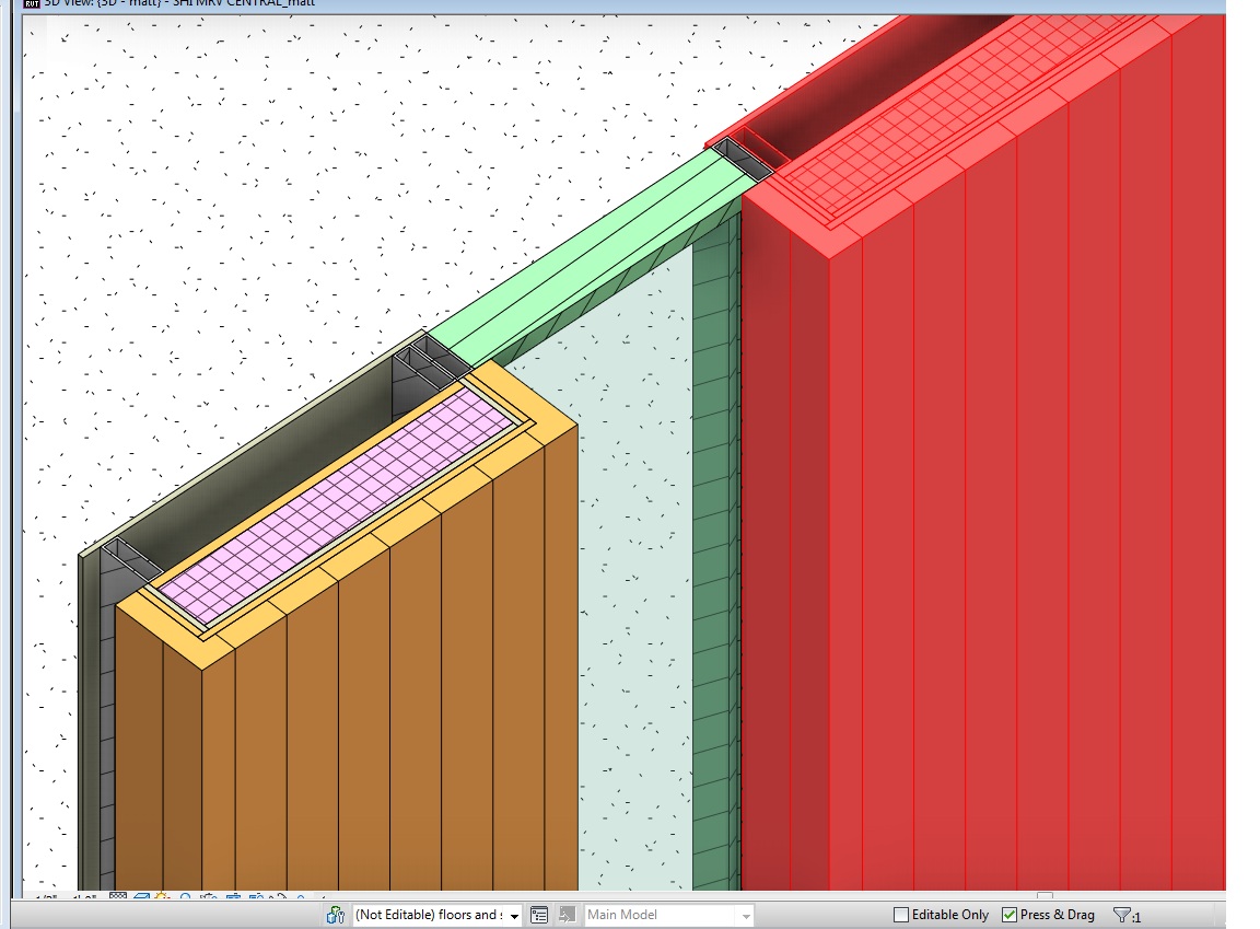

I build the majority of my families now.  It really beats searching for something vaguely similar to what you want, and not knowing if it even exists.  It takes some getting used to, but with a little creativity and understanding the mechanics of revit, you can save yourself a lot of time and get exactly what you want.   Lately I've been experimenting with curtain wall panels.  Making systems that interlock and have a high level of detail but don't break the bank on file size. Unconventional and a little weird to schedule, but it'll work, and look awesome.
