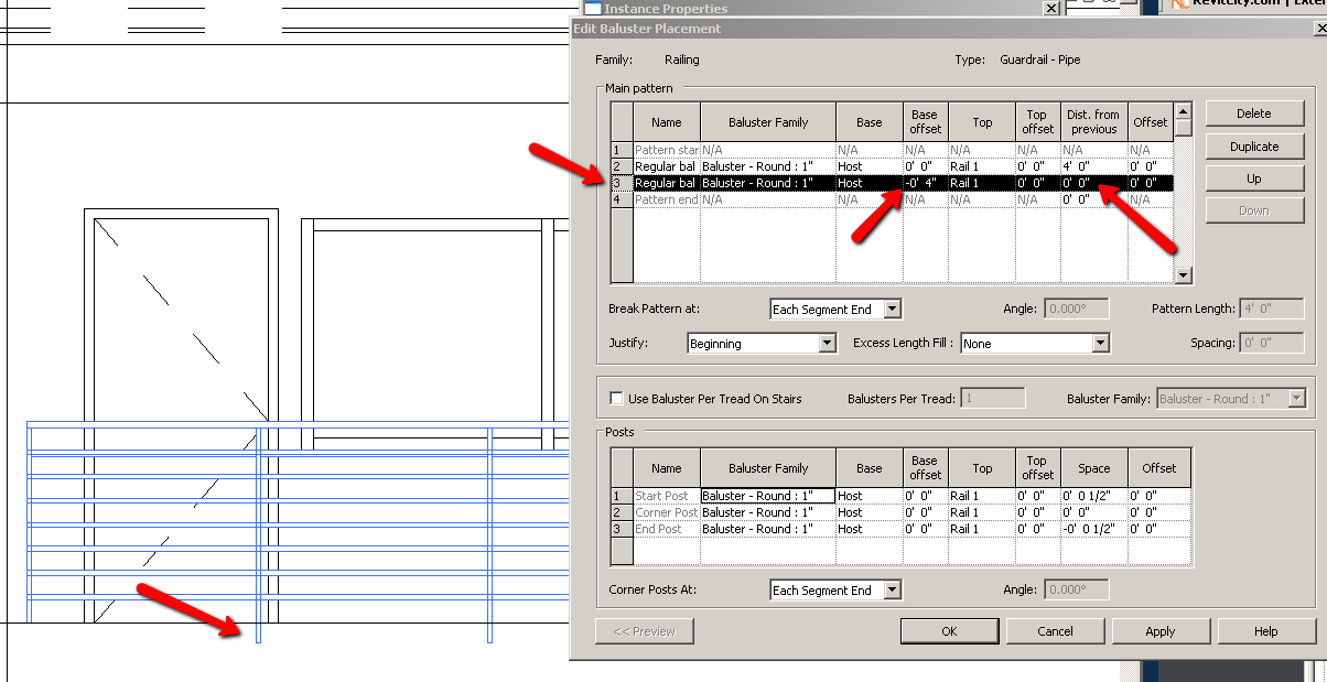

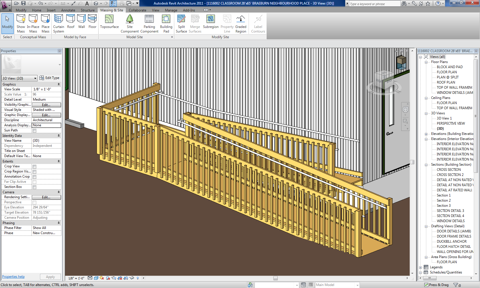

I'm working on a fairly simple ramp with a railing and need some advice. I've set up some 4x4 posts and I want them to extend to grade level. Under balluster placement, you can set the base of the post to align with the Host or with the different railings, I was expecting to see my different levels under this menu. Can anyone help me?

Create another baluster, give it a negative (-) base offset value and make the dist. from previous equal to 0'-0".
