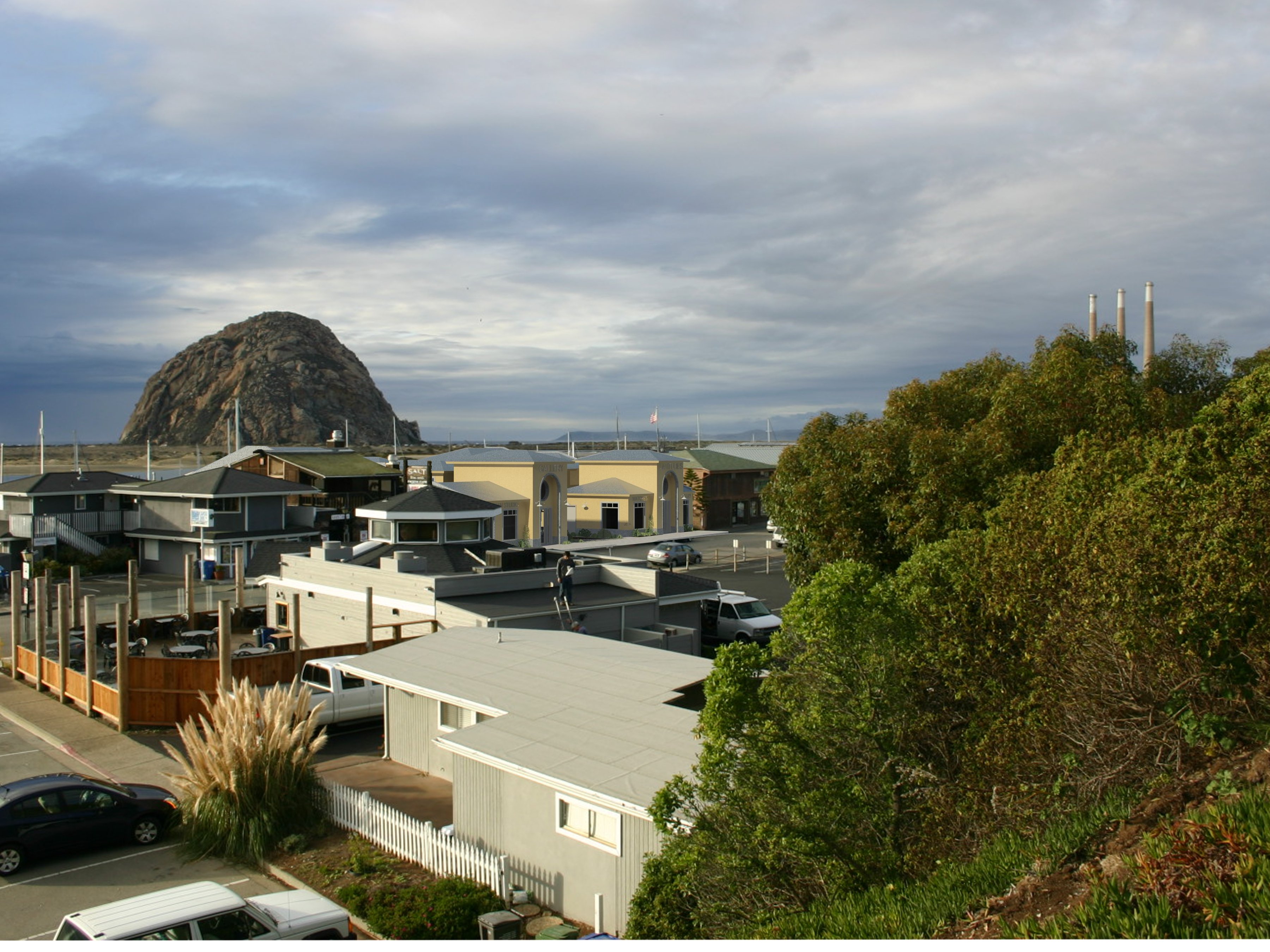

My experience and I have only done a few of these. is that you must calculate the position the original photo is taken from and place the Revit camera in the same relative location. This will give you the same angles, more or less but the scale will not be the same, as the Revit camera is not going to match the lens of the camera you used to make the photo. You will then have to make adjustments as to the position of the building, and scale it if you have created the street work fairly well this is what I use to get the position of the Revit model in the correct place, and to help with scale. In my case the photos have been taken at street end views, for planning approvals. Then I have run leveling line by survey instrument to obtain the correct elevation.

Sorry, the simulated building is the cream colored building with the metal roof, near the center of the photo
