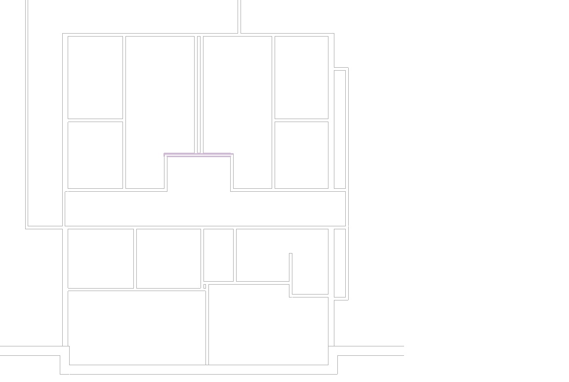

I am having issues where my ceiling grid will not show on my ceiling plan. I have everything that you can possibly have turned on and I cant see my ceiling grid (24 x 4Shadey on the layout. I can see it fine in camera and walkthrough views. Any ideas????

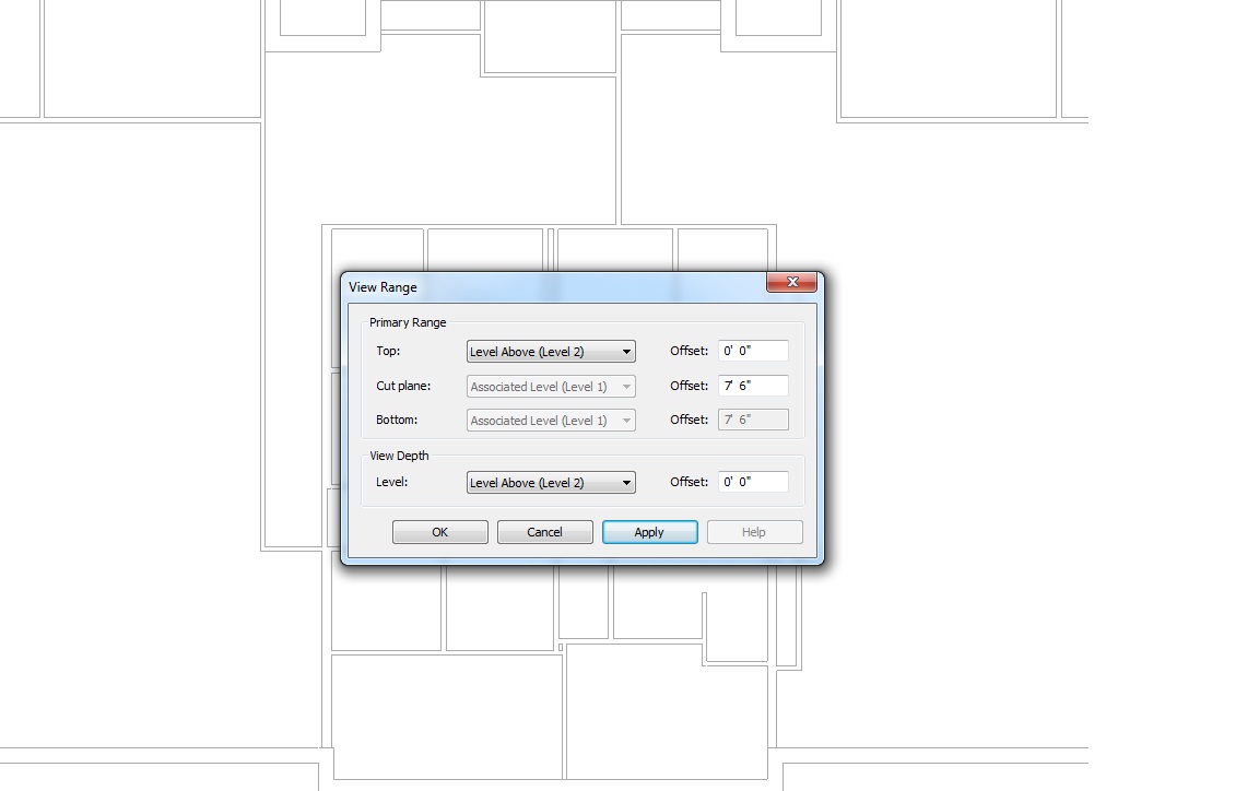

What are your View Range Settings, and Ceiling heights?

My ceiling height is 8'-0, my level1 walls are set to 9'-0. I attached a screenshot of my view range settings. what would i need to change to get the grid to show? As you can see I am pretty new at this.

Those setting should be fine (so long as level 2 is above 8'), you could try changing the view depth and top to "unlimited" just as a check...
Have you changed the phase of anything in your project? you chould check that under "Phasing" you have "Show All" and "New Construction" picked.
Wed, Mar 16, 2011 at 3:15:50 PM | Ceiling Grid
Assuming you are using a reflected ceiling plan and not a floor plan.... Have you looked at your VG settings?
