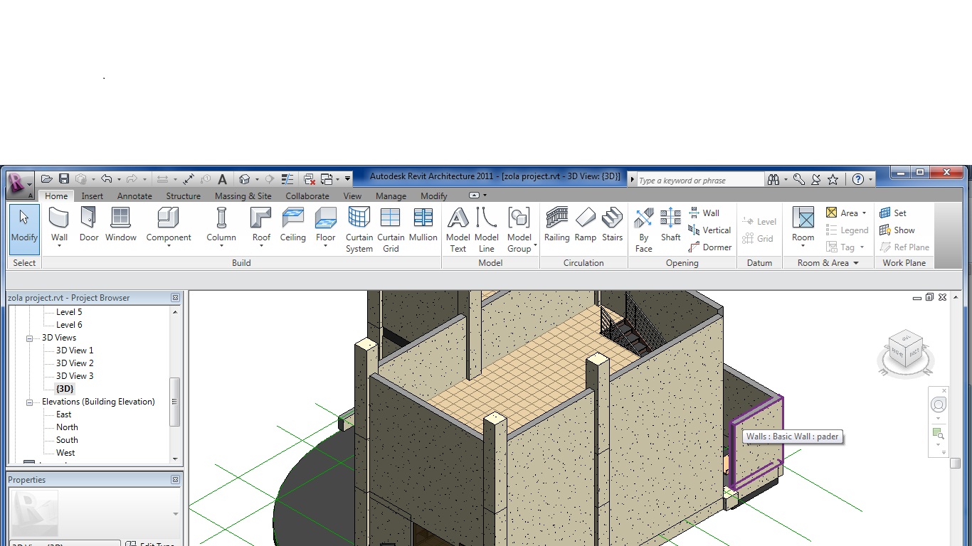

good morning, its been a while since i visited this educational site> ok going straight to my issue. i did follow all the steps typhoon told me. but still having some problem.i included some pictures so at least you guys will be able to know if what im doing is wrong.
picture1:as you can see, the building walls and columns have the same finishing,same with texture, (which earlier, was not suppose to be, the original color of my columns are suppose to be chocolate brown.but when i already drew the walls columns copied the finishing material which is beige.which i did not change on the column finishing) so what i did was to open another component(column and duplicated it and named it hey column)
picture2: i edited the material, when i opened the material editor i chose PAINT colored chocolate brown(applied it checked settings etc.
picture3:i placed the column on the designated grid(still doing fine)
picture 4 or 5 : i checked the 3d view and now the whole building is chocolate brown.
so going back: i am i doing something wrong ?>> because everytime i duplicate a material(say wall or floor)if i will use the material editor under the label TILE or PAINT the rest of the materials will absorb the finishing material>> the only time i can get different material is if for example i will duplicate and rename a wall and i will use a different finishing like stone or any material that i did not use before.
i tried another column using a stone(that did not interfere with the walls

It sounds like you are not duplicating a material, you are duplicating an element.  Walls floors ceilings are all build up in layers and the materials are assigned to each layer.
Architectural columns will assume the material of any wall that they touch.
