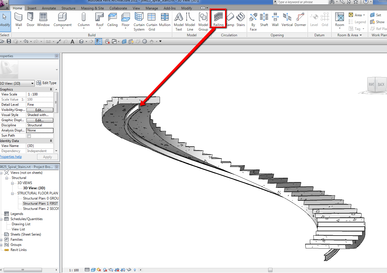

Anyone know how to attach a beam to the underside of the stairs within the atachment ?
everytime i try i keeps adding little sections of beams instead of one full beam
cheers

Something like this? use the "Railing" tool

thanks for your reply
how do i do that using the railing tools step by step ?

can anyone tell me step by step how to do that using the railing tool !
its something ive never used before

Watch the video: http://screencast.com/t/esm3n2ZvoUR

Great Help Cheers

is the a way of changing the railing profile to a RHS 250x150x5 ?
Wed, Mar 16, 2011 at 8:09:02 AM | Stair Problems !!!!
Read your HELP on railings.  Especially: Modifying the Railing Structure  It will also lead you to how to create your own rail profile, see The Families Guide.  You can find the Families Guide on the AutoDESK Ssite on the web.
