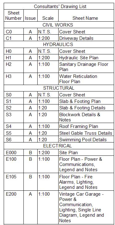

In a revit drawing list, is it possible to modify its properties so that you can have certain drawing sheets grouped together with a corresponding heading above it? But all in the one drawing list?
For example:
If you had a set of sheets that were related to the "Civil Works" of the project, you would want them grouped together at the top of the drawing list with a heading above stating CIVIL WORKS.
Then underneath that, you had a set of sheets which related to the hydraulics of the building, similarly with a heading above it.
I have checked all the available properties for the drawing list, including the sheet properties and their visibility in the drawing list.
I have attached an example of what I am trying to explain, however it is simply 2D lines and text.

Under Sorting/Grouping sse Sorting Order.
Then for each discipline assign them a number. 1, 2, 3. Then the schedule will first sort by sorting order then by sheet number.
Tue, Mar 15, 2011 at 10:46:32 AM | Revit Drawing List
Actually, If you
  1. add a category parameter to your sheets,
  2. you can sort by that category, then sheet number,
  3. turn header on for that category
  4. and hide this column.
And get something like I've shown.
