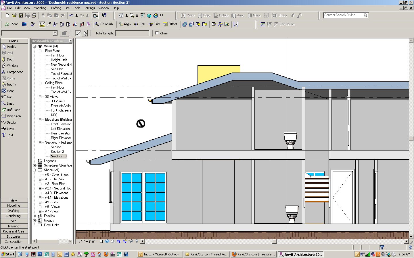

So I took a screen shot. Take a look at the image and let me know if you see anything wrong with my settings..I want to measure the top of wall from floor to the roof. and the measure tool doesnt want to do it. I "illustrated in" what the cursor looks like (the screen shot doesnt capture the cursor).
 Im proficient at revit so its not a noob move like the wrong tool... but I cant figure this out.

Then it seems like a bug to me
Tue, Mar 15, 2011 at 1:11:05 PM | measure tape in section doesn work
Works fine in my Revit 9 section view.  Cut a new section.

THanks a lot! the deleting of the section and a redraw did it. I gotta remember that trick more.
