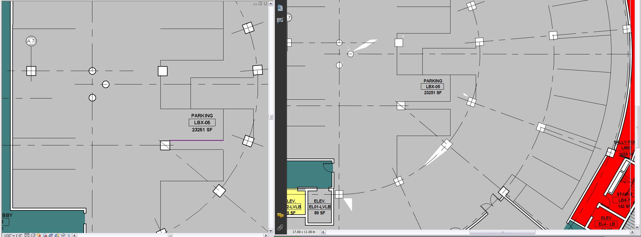

I'm not sure exactly what is happening here, but everytime I print my colored plans there are strange instances where the color has holes in it. There is no display error with the file in Revit, just when I print to PDF. The colors come from the space objects in the room. See attached image.

Wierd.... I don't use PDF to print, only DWF, did you try printing in DWF to check if the problem persists?

Still no luck. What I did discover though is that the errors in the fill are showing up in the revit plot preview as well. I've tried moving building pads and site out of the way but it still is doing the same thing. Not sure what I've done to have this happen.
