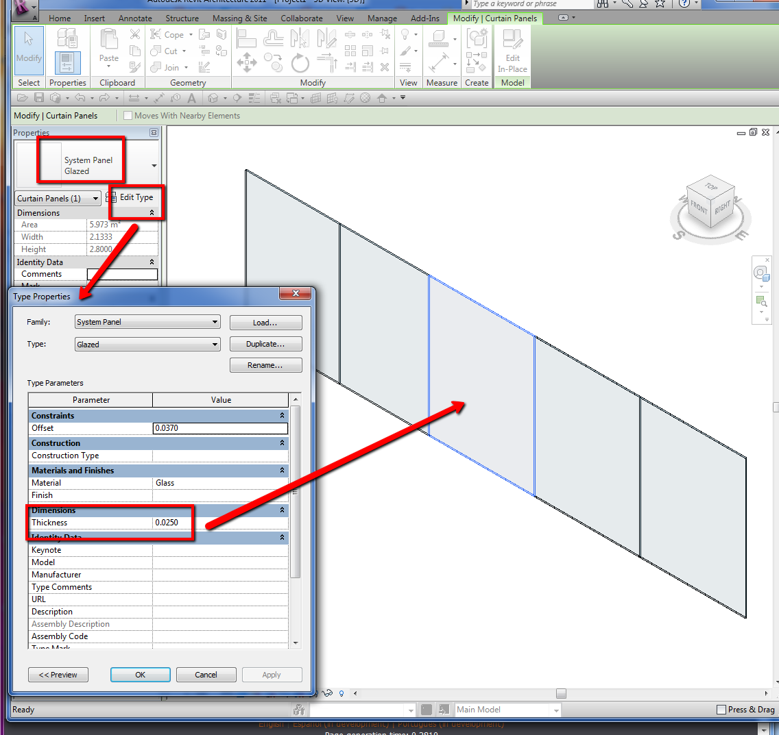

For some unknown reason, my curtain walls are thick as hell. I can't get into any editor to change that. I enven looked in the management tab without success.
I tried to make a different wall and choose a 1 layer material: glass. Unfortunately i can't add a mullion to it.
I tried copy pasting from other project, but it changes to the thickness in the current project.
I googled it and seems either i didn't choose the right words or no1 has runned into this kind of situation before.
 Any suggestions/ sollutions?!

"For some unknown reason, my curtain walls are thick as hell." - Are you talking about the thickness of the glass?? If so, just select one panel (use the TAB key if you need) go to properties>edit Type and change that.

This is not a standard wall, it is a curtain wall. And yes i was talking bout the glass thickness
In revit 2011, you cannot edit the thickness. Maybe you can tell how to edit the keynote, that might help

"And yes i was talking bout the glass thickness In revit 2011, you cannot edit the thickness." - Who told you that?
Again:..... just select one panel (use the TAB key if you need) go to properties>edit Type and change that.

Oh, i dont have that.
And sorry about my tone, now i see it was a bit rude(alot actually)
I couldn't do that. Insted i moved the entire project to another file which had a normal thicknes of the curtain wall. That did the trick.
