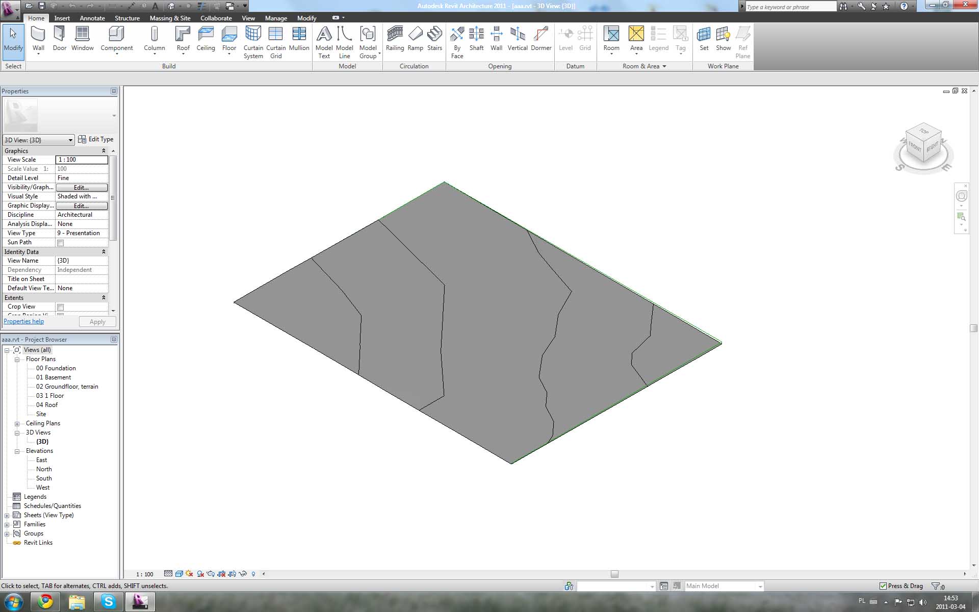

 Im actually preparing a site to present my conceptual design and i found a such a small but very annoying problem.So on:

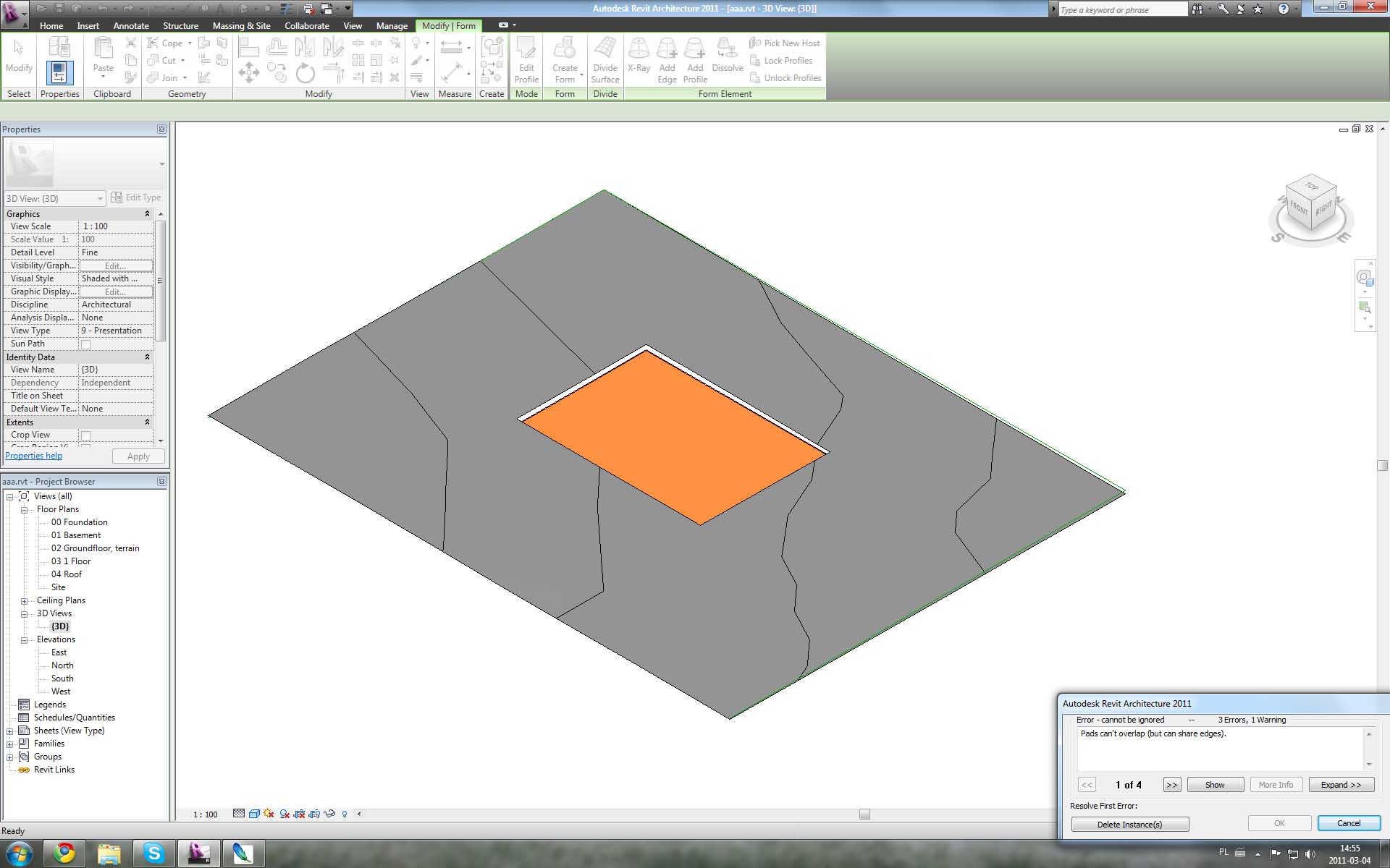

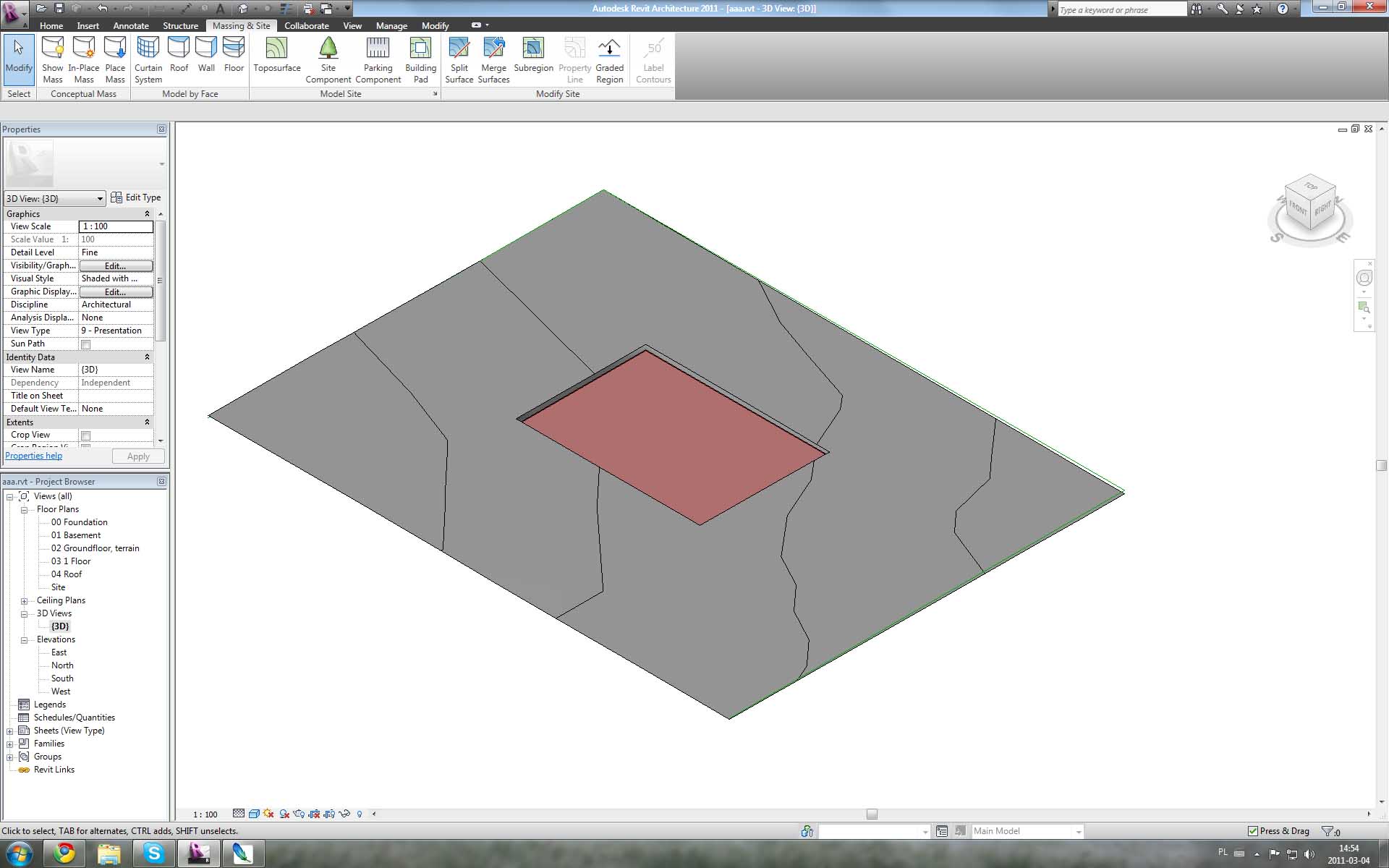

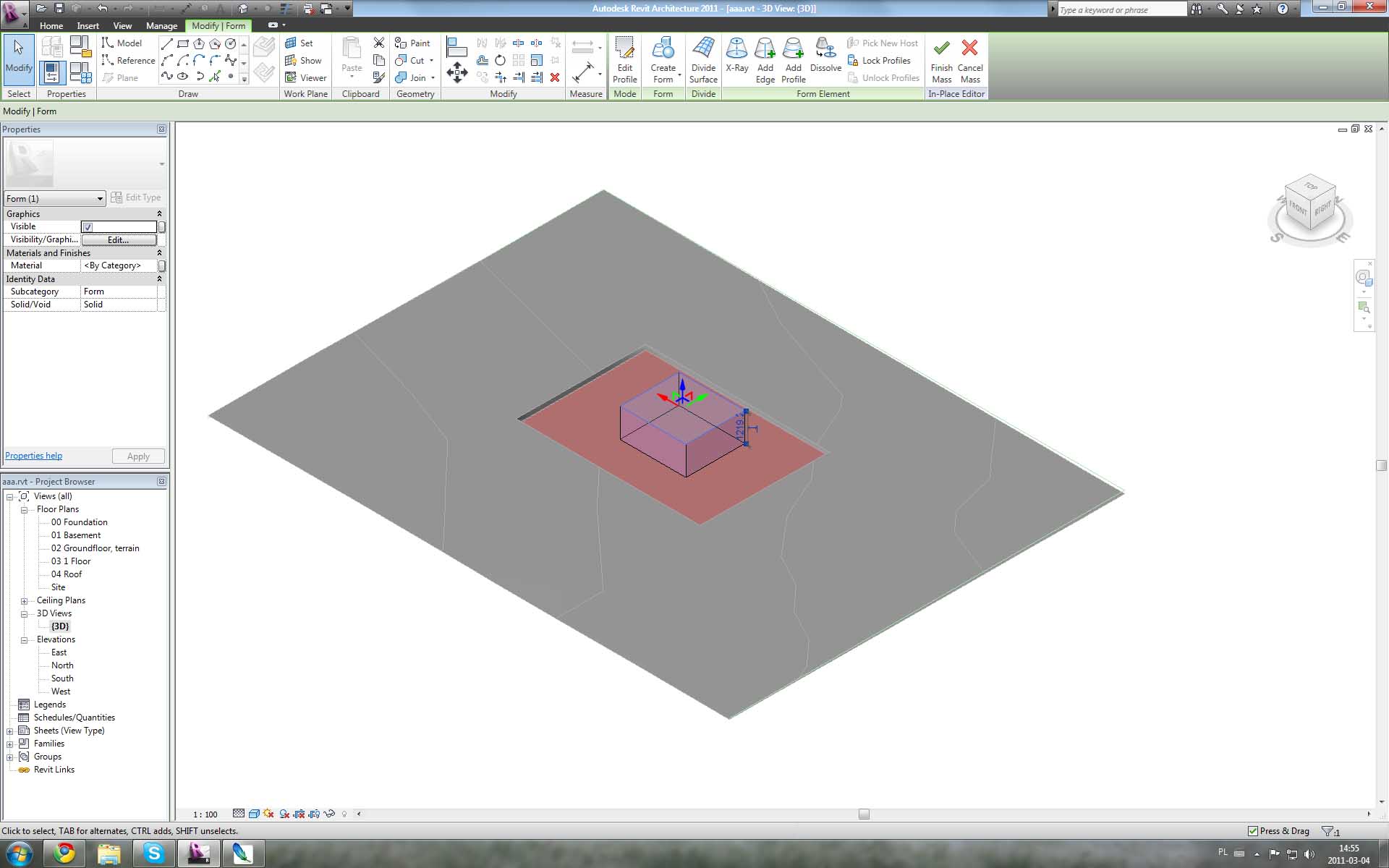

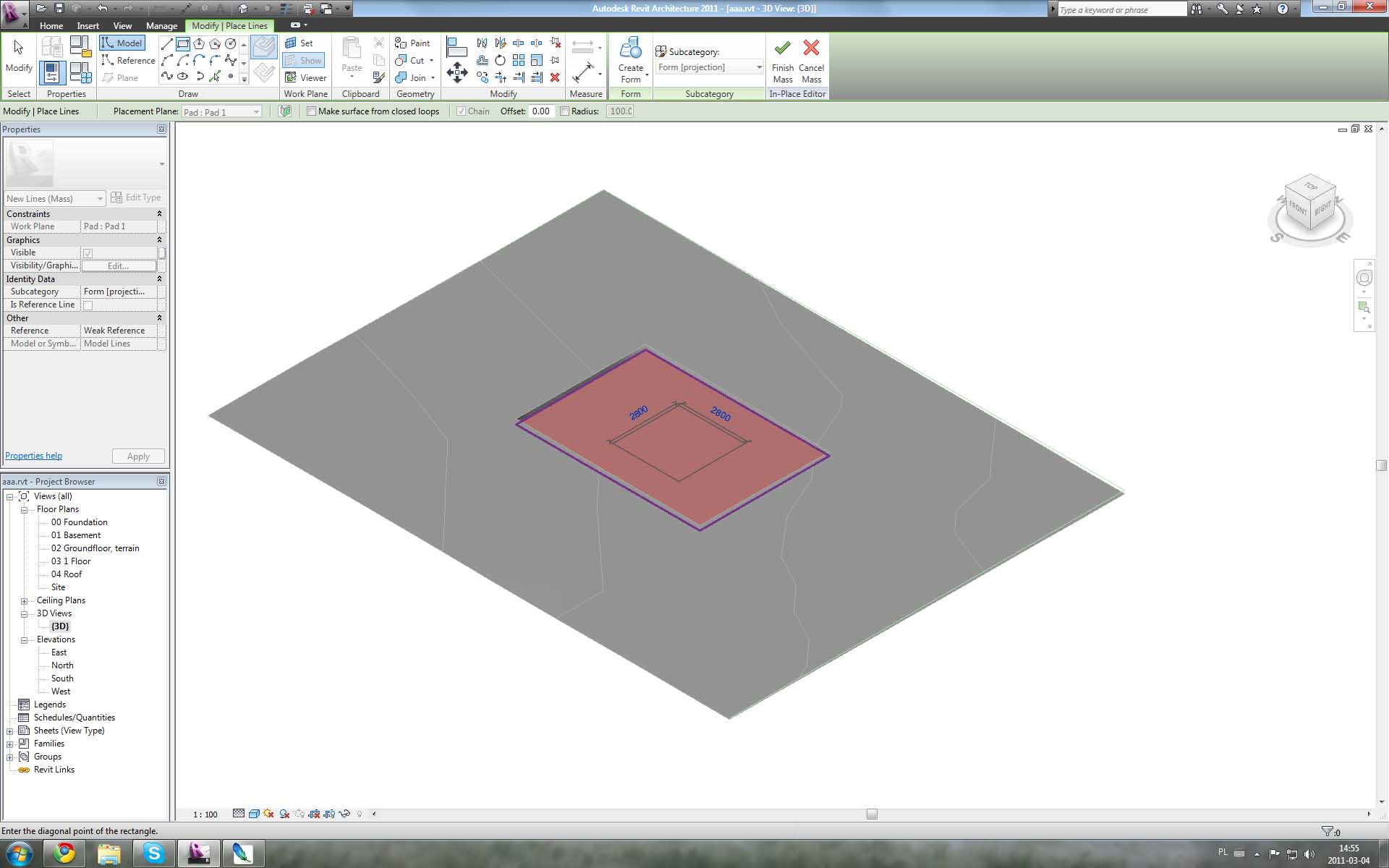

1. ) I have a dwg. improted toposurface and 2. ) I made a building pad on it.3. ) going to in place mass and setting my new building pad as workplane4. ) drawing rectangularish shape, creating form and clicking finish5. ) got the non ignorable error - Pads can't overlap (but can share edges).so, how can i make my building pad as a host ?? like this guy in 5:38 http://www.youtube.com/watch?v=0f4RMTD-_So

I saw the video and I can assure you when he create that mass on "PAD", he don't select the the "workplane" of the PAD but he select the Family mass's workplane already existing. Something like this: http://screencast.com/t/bUBKswoPBb
Steve:  http://www.youtube.com/watch?v=0f4RMTD-_So
