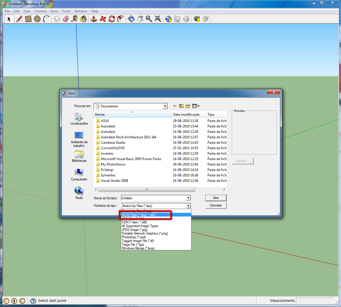

"Sketchup doesnt take .dwg unless I missed it" - Just "IMPORT" and select "Dwg - Dxf" format

I have the current version and I dont show anything for importing .dwg. Am I missign something?

Look under import not open.

i think you need a (free) plugin to import dwg into sketshup in the newer versions.

I know this is an old thread and I'm sure everyone knows by now that Sketchup FREE does not support and DWG or DXF file import. You must have the Pro version.

You need to have Sketchup pro version to import .dwg files
