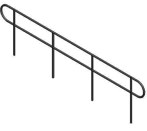

Does anyone know how to create this type of railing?
Thanks

Use Baluster Family to make the "end post" and use profile to create the top and bottom rails.

Heres an example.
