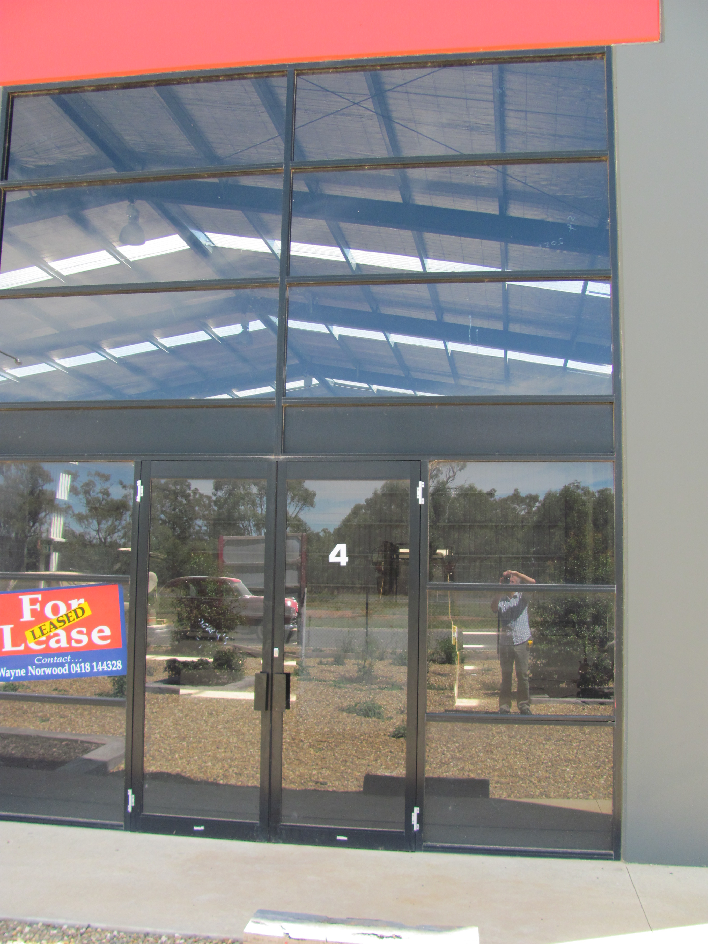

I have just created my first curtain wall for a project in Revit 2011 & although it will probably do the task I want of it I would like to know how to adjust a few things.
All I am doing is recreating the existing one to carry on & document the office space in behind so I am not actually designing it for construction. I have attached an image of the existing.
  • The c/wall with the doors is actually two c/walls which is not what I want, I want one c/wall with a pair of doors in the middle.
  • Additionally the mullion above the doors needs to be about 300mm or about 12" size does not matter but I would like to know how to adjust it. This mullion is at 1st floor height so it will hide the floor structure.
I would dearly appreciate any assistance.

Hello Pele,
First off, you need have a double curtain wall door in order for that to work. don't put two single one together
there should be one already come with the box.
when you composed the curtain system as one wall, you should be able to select the curtain grid (by individual or by the entire length) then once you see the push-pin, unpin it and you should be able to move around the curtain grid, when u do, the mullion will follow.

Phew !!
I did it, thank you very much pchan, see attached
