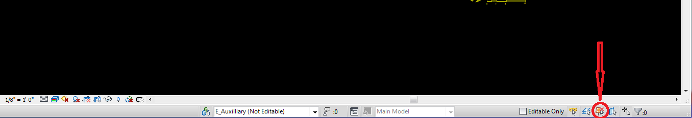

Try to check your status bar.The "Select Pinned Element" mark as "x" located at the lower-right side of your screen.Remove the sign "x" by clicking. then try to select the wall.
And if your wall is a Revit link use TAB to be able to select.
