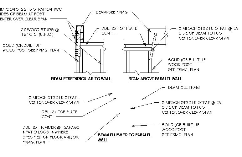

WWHub is correct to point out that masking regions can be used to "mask" unwanted portions of detail components in drafting views.
However, this has the undesirable side-effect of creating a drafting view with a over-sized (potentially vastly over-sized) pick box - ie the area that becomes highlighted when you roll over the view on a sheet.
This becomes annoying while trying to select the correct view. Not to mention the messiness that comes along with excessive masking regions in a view.

Another reason that crop region for drafting views is that importing CAD files can create strange pick regions, as bavery99 pointed out.  Really its a legitimate wishlist item.

Not a large DWG.  I've converted everything to Revit lines, and Revit text styles, and the view is still quite large.  Again, a crop region would be helpful.  This is a wishlist forum.

The crop feature in drafting view is on my wishlist because I use detail components to help create my drafting views.  Without a crop view, the length of the compnent from the detail library dictates the size of my drawing.  This makes things like door jamb details larger than they really need to be unless I go back and re-draw everything on the screen with detail lines and regions.  A crop feature would be a timesaver for me.
