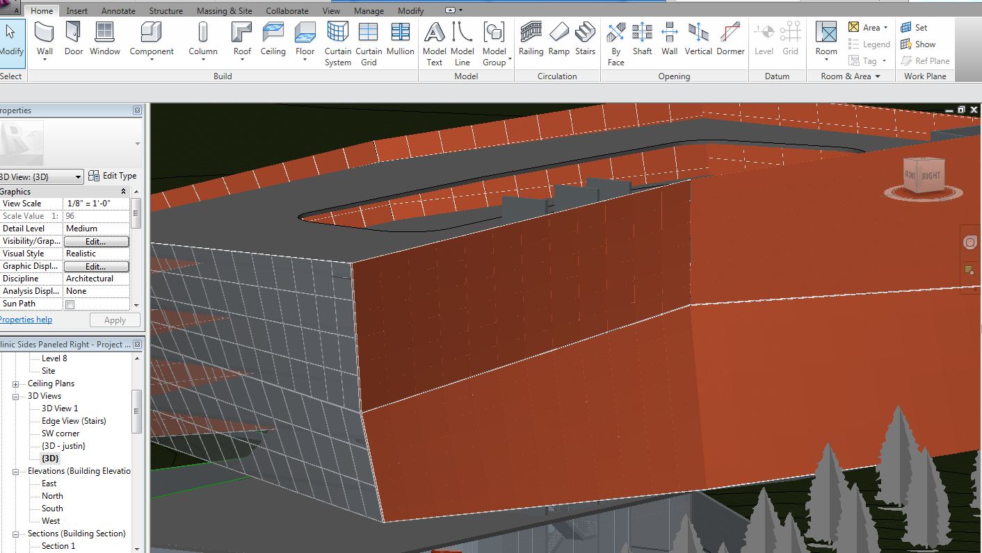

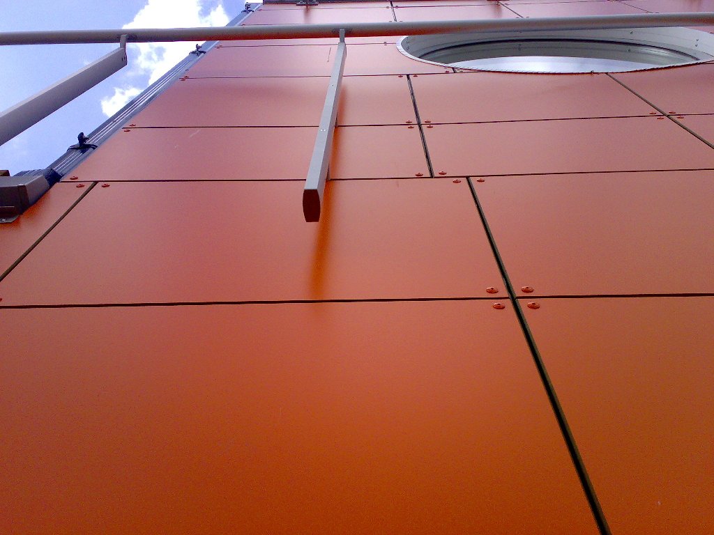

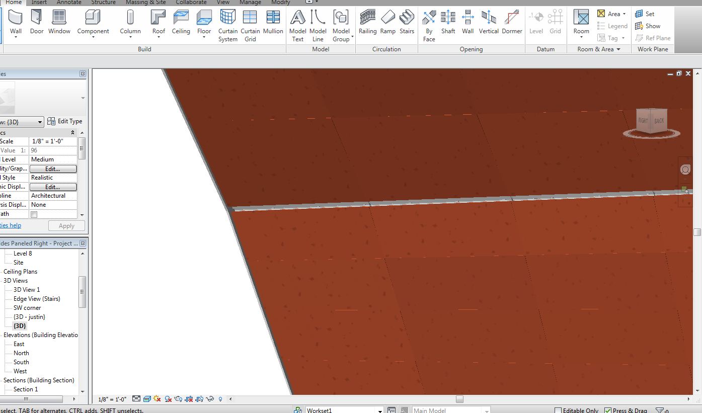

I am trying to create a Trespa Meteon type look for my facade.
I cannot figure out  how to create the reveal look in my panel system.  Any ideas?  Thanks.

Like I said in the other post you ask: "Curtain Walls", just create a "Curtain wall panel" family like you want, in project divide the curtain wall like you need and replace the panels by the NEW panel you created.
Something like this: http://www.revitcity.com/gallery.php?action=view&gallery_id=7803
