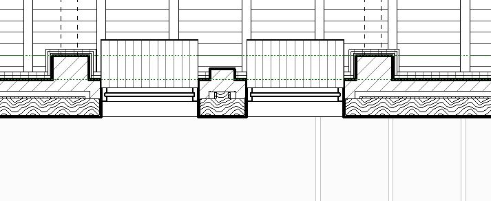

See attached image and family file.
Any idea why the brick sill is showing up in the reflected ceiling plan?

I looked at it and I thought that the window is within the view range in the RCP and therefore, the sill shows up.
One way to get around this is to assign the sill to a subcategory (sill) and you can un-check the box from VG setting the project environment.

thanks pchan! worked.
