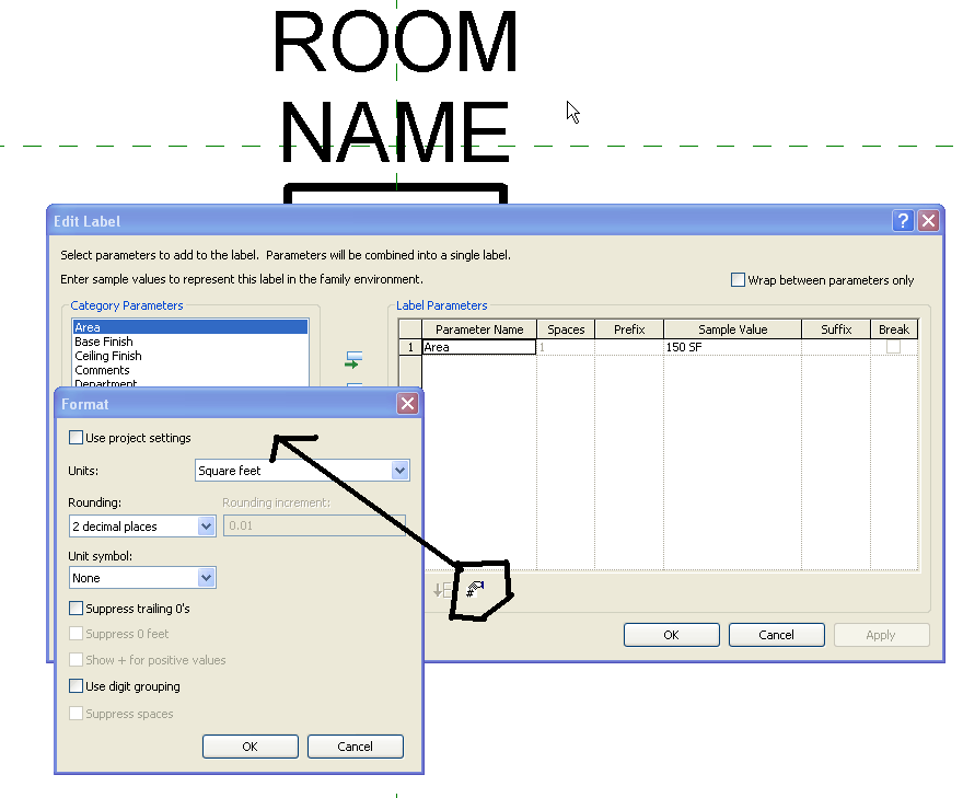

We are doing a project in Metric and the client wants to see the areas in both square meters and square feet.  i know you can only have the project units set to either one or the other so i was wondering if this is possible.
 i was trying to use a shared parameter that would multiply the square meter by a factor of 10.76391 but i couldnt figure out how to use that parameter in the tag because you cant reference the square meter label.
any help would be greatly appreciated
thanks!

Answer is here - http://www.revitcity.com/forums.php?action=viewthread&thread_id=16497
Life's a reach, and then you gybe
Thu, Feb 2, 2012 at 11:51:45 AM | Area Tag with both SF and M2
There is a better answer than that link.  Create your room tag with two areas.  Set one to metric and the other to english units.
