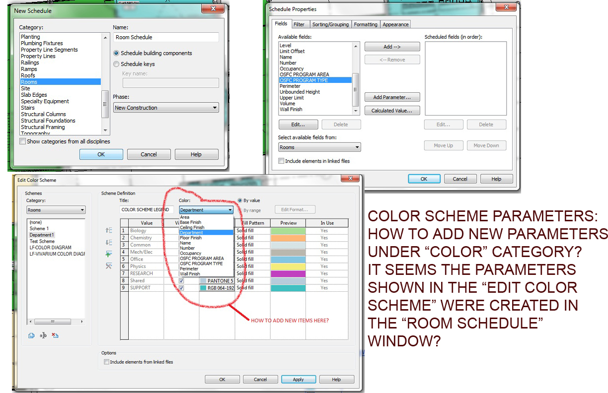

Please see jpeg attached.
I'm trying to add items and/or parameters to the "Color" category in the edit color scheme window.
Any ideas? Thanks.

you could add a parameter to your rooms called color where you then fill in the color yourself as a text,
and then use that parameter to setup your colorscheme.

ok. so how do I do that....tried looking everywhere and I don't see how to add a parameter to this "color" category in order to assign colors to it.

make a new shared parameter in your project parameters
assign it to rooms categorie
