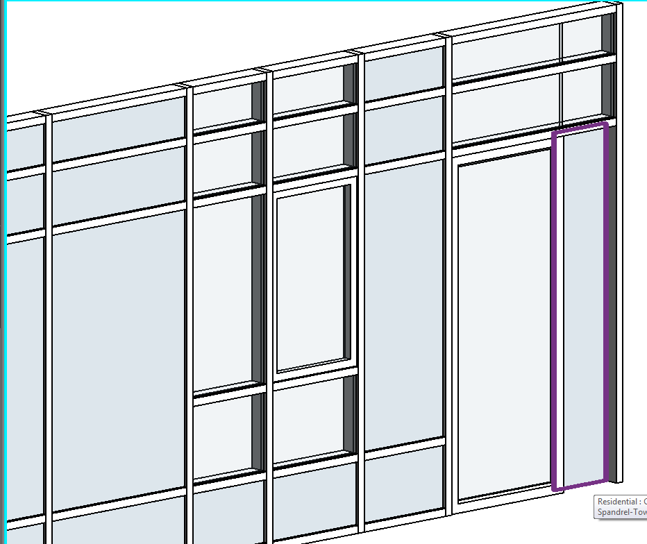

I'm having what seems to be a glitch problem; one of my curtain panels in my regular wall-curtainwall is facing inward while all the other panels are properly facing outward.  If I select it, it is identical to the other panels, but facing the wrong way.  For the heck of it I selected it and picked 'edit family', did nothing, and finished the sketch, and the curtain panel deleted itself... there wasn't even a curtain panel in that position anymore (not even an empty panel).  If I edited the profile of the wall (which had never been altered), it showed the full rectangle of the wall, but with a void where the curtain panel used to be.
Any ideas?  I'll be able to get around it by creating a new wall, but its not a reasonable solution if it frequently occurs.  So far I've seen it twice in an hour.

It happens to be a spandrel panel (image attached showing the highlighted panel) which is a standard curtain panel (nothing custom about it).  It is identical to the other spandrel panels, yet it faces inward.  I tried edit family just to see what was going on an like I say, when I finished the sketch it completely deleted that portion of the curtainwall.

I think I ran into a "backwards" panel one time.  Not sure how it happened but I believe the best solution is to create a new CW.  Something got corrupted.

yeah I hear you.  Its nothing I can't get around, but I figured it was worthwhile posting to see if anyone else had come across / solved it.  I ended up splitting the wall, deleting that portion, dragging the existing piece out and creating new grids.

I just figured it out. Turn the glass panel into a door, reverse the swing, and turn it back into a glass panel.

Just wanted to say that I was trying to figure out this same problem and although I had changed the direction of the door it didn't work for me (at first...).  I was changing the swing relative to int/ext, not right/left.  After reading this thread I tried toggling the left/right orientation and it did the trick.
