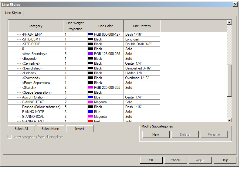

I have no idea how this happened but I have lost the ability to draw Invisible Lines.  Nor can I find a way to recreate this style or transfer it from another file.  If I load the default templates (residential, commercial, etc.) they too do not have the Invisible Line style loaded.  Somehow it has been removed.
I can create detailed line Family and use invisible lines, if I copy those Invisible lines while in the family into my project...they convert to thin lines - not invisible.
Any suggestions how to load the Invisible line style - which I think is a System Line Style.  I thought System line styles could not be deleted.
Thanks
Mon, Feb 21, 2011 at 12:10:18 PM | Invisible lines removed from Line Styels
In a project, unlike a family, there are no invisible annotative lines - only model lines can be changed to invisible in a view and region sketch lines can be invisible.
