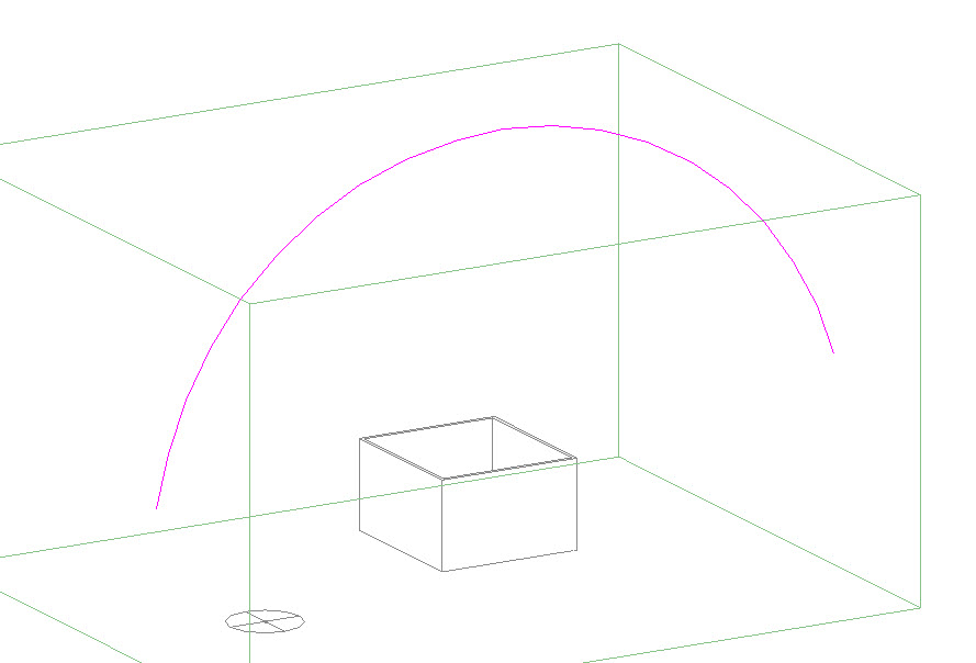

So, here I am attempting to try someone's idea of creating a curved wall that goes up to the bottom of a curved monolithic stair by creating an extruded roof etc etc... (seen in a forum).
I cannot create an extruded roof! I've followed the directions in a book, and the Help files with no luck. I am greeted with the message "can't make extrusion" each time I try. Obviously, I'm missing a step or some such thing.
 Here are the steps that I've followed:
1 drew 4 walls
2 created a reference plane parallel to the 'front' wall & gave it a name
3 selected 'roof by extrusion', selected the 'front wall' reference plane & selected the 'front' view
4 sketched an arc shape (also tried a pointy roof!) and finished the sketch
5 was greeted by 'can't make extrusion' message (over & over).
 If anyone is out there today, would you be so kind as to offer a pointer???

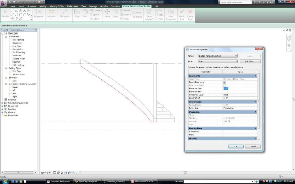

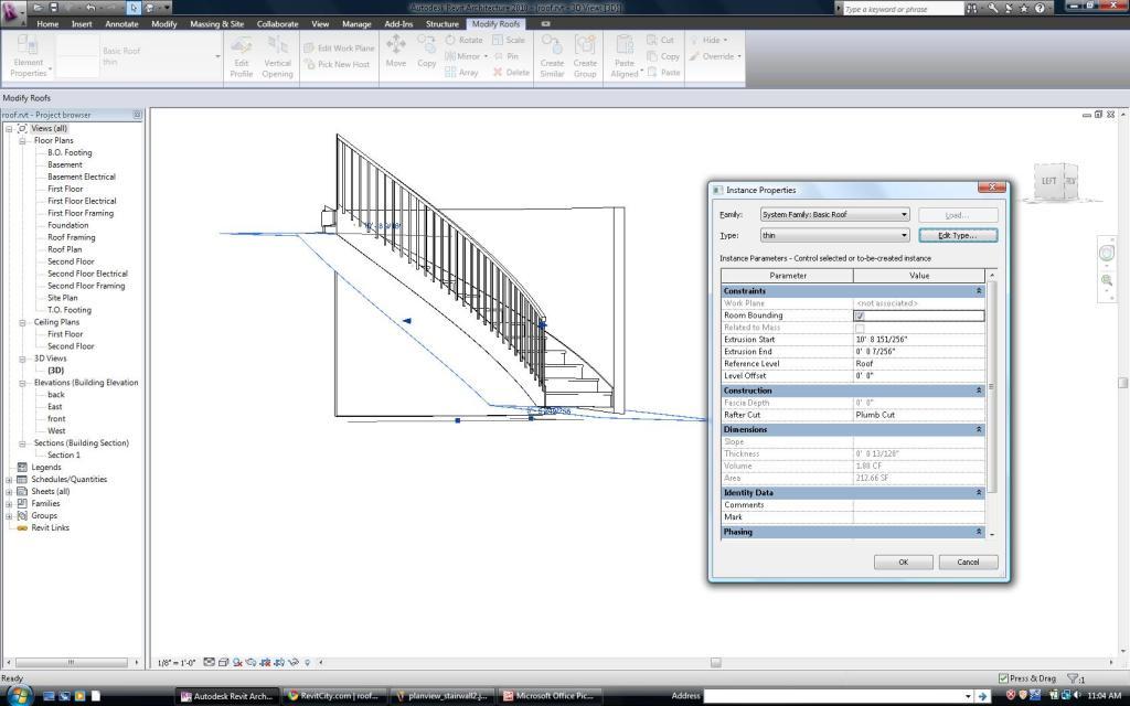

Mon, Feb 21, 2011 at 12:22:42 PM | roof by extrusion not working
sroreilly
Joined: Mon, Jan 17, 2011
97 Posts
Thanks for replying....
I did finally get an extrusion to work. So, I've gone back to the curved stair & wall to try again.....
I managed to make an extrusion & get the wall to attach, but I'm sure that I did it wrong. In answer to your list:
1. ref plane: front, elevation: front (attachment #1)
2. didn't use a closed loop
3. I think this may be where I'm losing it. See attached please? (#1 & #2 is what I'm attempting now, #3 is what I got to work) #3 I created from the second floor, #2 I'm creating from the 1st floor (just to confuse myself even more!)
4. roof type: created 'thin' with 1" thickness
Well, I'm sure I've not explained myself very well before, is this better? Maybe I need more coffee?  Yep, tryin' to keep my sense of hah-hah.

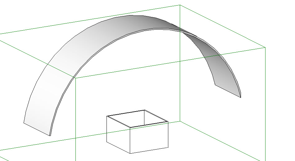

Tue, Feb 22, 2011 at 4:13:03 PM | roof by extrusion not working
sroreilly
97 Posts
It seems that I cannot make a thin extruded roof by picking an existing line or edge.
I have made a thin extruded roof by drawing lines. But then the wall will not join the roof.
Still be-fuddled. Confused. Frustrated.
This seems so wonderfully straight-forward and simple, yet I cannot get it to work!

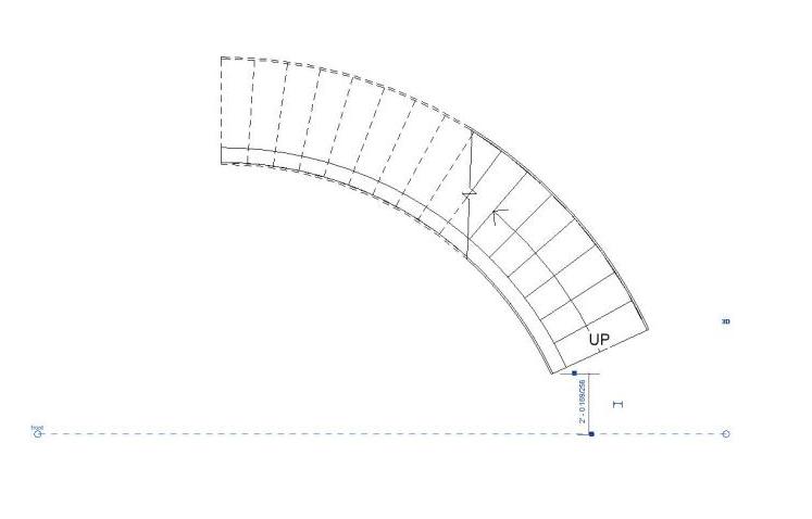

Sat, Feb 26, 2011 at 1:41:39 PM | roof by extrusion IS NOW working!
sroreilly
97 Posts
This past week I got this problem licked. :o
Seems I just don't yet get the Revit lingo.
I placed a reference line parallel to the curved wall & staircase that I wanted to edit. (Well, as parallel as you can get to a curved wall....) Yes, even though I read parallel & wrote parallel, it never sunk in. (Must've been the bad cold.)
I also placed a section view parallel to these items. I then created the thin roof, stretched it around as required, made sure that it was a little bit above the wall at the lowest portion, and attached the wall to the roof.
Voila. Success.
Thanks for the attempts to help.
