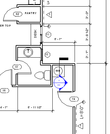

I'm trying to remember how to generate a section label and then refer this label to an existing view imprted from a cad file. I have a water heater detail, (drafting view) already brought into a mechanical sheet. Now, when I generate a section tag on teh floor plan, I want it to refer to that view.
Also, trying to remenber how to shrink the section tag. It's way too large in at it's default size. see attachment.

Pick the view type you want to call out then on the options bar check the reference other view - then pick it from the dropdown then place the callout in your view.
