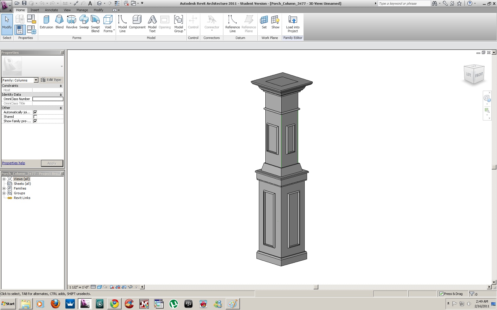

I downloaded a column from the downloads section...but edited the family to make it look like more of what's going into the real-world project.

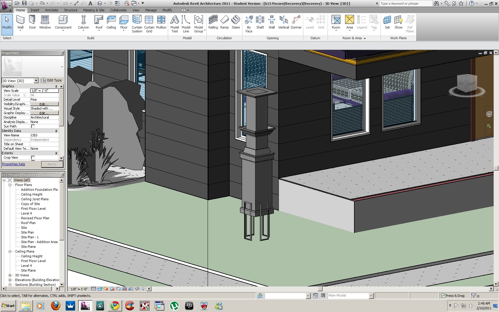

When uploaded and placed into the project, the sweeps are not aligned or attached to the column.
The pictures tell the store, and I have also atatched the actual Column file.
Any help is appreciated in advance!
JZ

The crown molding at the top is out of alignment as well...and I didn't adjust/change that.

Your geometry is not constrained.  You need to fix your geometry to reference planes using the align command, and locking.  This is family creation/modification 101.  Do you know how to properly constrain elements within a family?
The order of families (this is how they should be built)
1.  Reference Planes
2.  Dimensions
3.  Geometry
Do you need additional help?
