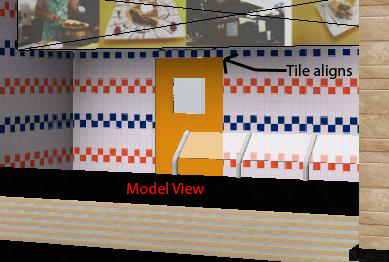

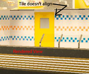

Greetings again all. trying to align a tile pattern with the top of a door in revit architecture 2011. I opened the materials editor/ click render appearance tab/ click on jpg image that I imported under "ceramic"/ click on transform/ click position/ change dimensions under offset until the tile pattern aligns with the top of the door in the model view. Looks good, so I hit render...and the tile pattern is unchanged...still in the original position in the rendered image (see attached images). Does anyone know how to fix this?  Appriciate the help...

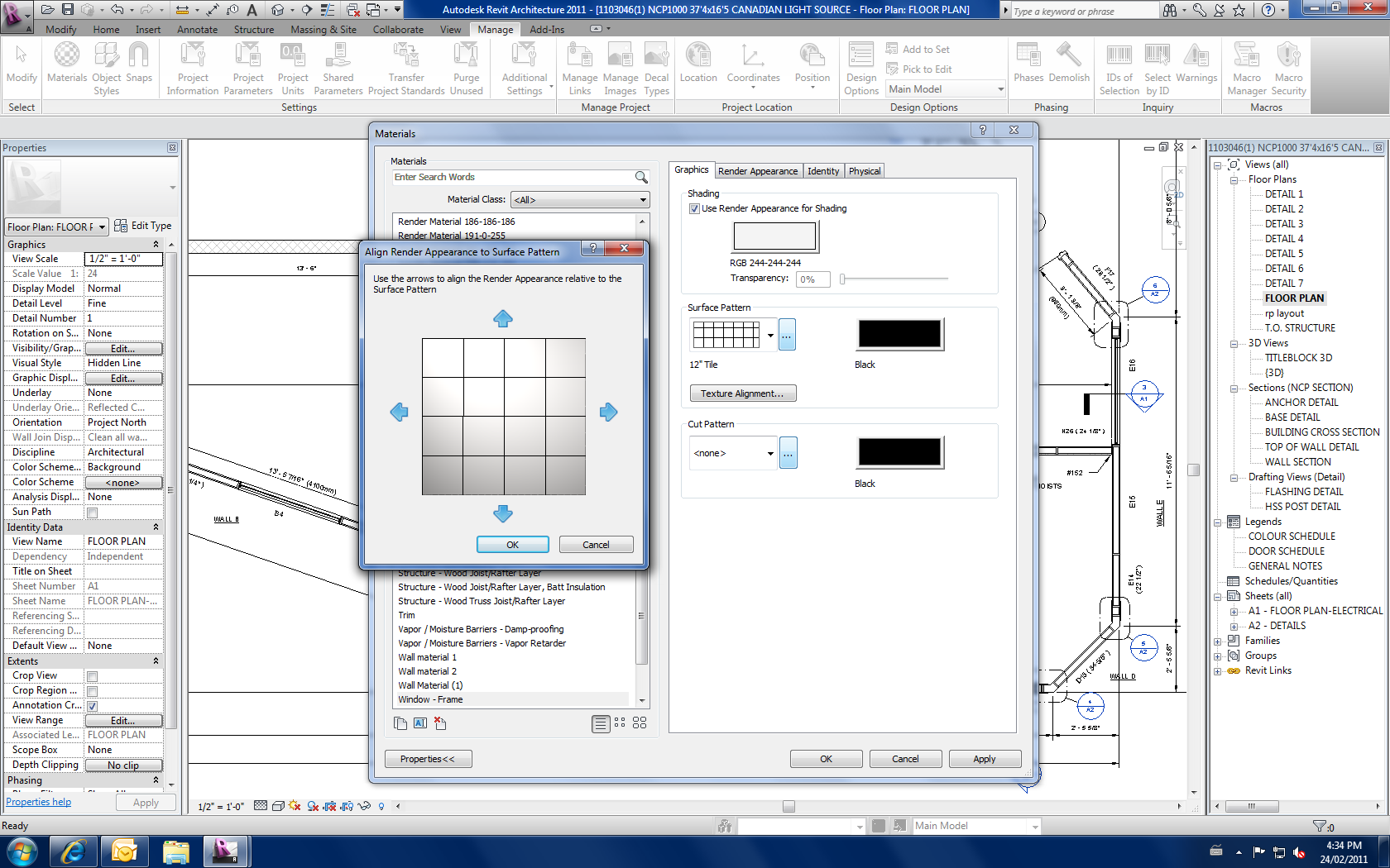

Try going to the Texture Alignment... Button under the surface pattern for the material. This align's the surface pattern with the render pattern.
