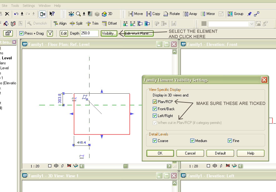

I have just added benches and cupboards into a kitchen, and find the floor finish is showing on the plan right through them. The cupboards under the bench is also showing through the bench. The View Range Cut Plane is set at 1600mm. Anyone know what the problem would be? It looks fine in section.

As eldad alluded to. In your family the actual model element is most likely set not to display in plan view. Select the 3D elements and go to there visibilty and set to show in plan.

As mentioned above you need to EDIT THE FAMILY. Its not a setting in VIsibility/Graphics Overrides... You need to select the 3D element - go to its properties - click visibilty button - tick show in plan and when cut in plan...

Audrie, You still seem to be missing what i'm telling you... Have a look at the attached image. Open the family then select the 3D geometry then do as specified in the image.

Thank you Mr Spot. I got that. and now have the bench and fridge sorted out. Both are set in the models themselves to show on plan. As far as the toilets and sinks though I still have the same problem. While the models themselves say that they are showing in plan form, the ceramic tiles are visable through them.

Well, I managed to fix the sink and toilet by going right down to their base parts and making them visable in Plan. Even though the overall item said it was visable in plan, the parts weren't. So problem solved. But you have me interested in this "Rigion' Eldados, - it is like Autocad's Wipeout Command or is it a form of hatch? There is nothing about it in the help files.
