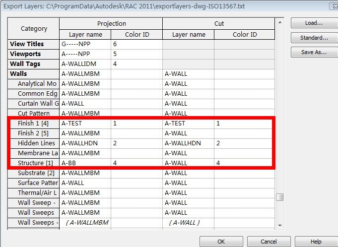

Hi,
I am trying to export Revit to CAD in order to meet our office standard.In the "export layers DWG option", I have assigned the different layers for different wall subcategory,for example I want the finish with one layer,structure with one layer,etc(like to JPG showed).But when it export to CAD, all the layers still remains same name(regards my subcategory setting), is there anyway can make the CAD layers name consist with my"export layers DWG option" setting?
Thanks in advance !

in plan view you would be adjusting the cut settings not projection.  hope that helps.
