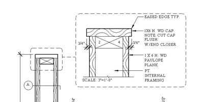

We have a number of details with blow-ups adjacent to the main detail. It would be nice if Revit had something similar to the plan region tool (except for scaling) so that I can dimension for two different scales in the same drafting view. Anyone have any suggestions on how to achieve this? All I can think of is to set up two separate drafting views with two seperate details then overlap two views on my details sheet. I guess another option is to manually input the dimensions using lines and text. Post edited on 2005-11-07 20:23:31

yeah mate, you will need to have 2 drafting views and put them together on a sheet...
